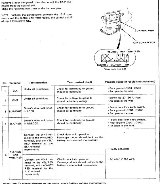

Power Locks - I'm in the dark on this one, I took the notorious drivers door panel off to adjust the window and since haven't had power locks, I've replaced the fuse under the hood even though it was fine, replaced both switches and some of the locks not all, but tried having one by one unplugged, even replaced the little gray box in the drivers door and no response. Before I "take it in" is there anything else that anyone would try?

Stock ride height on the car?
Have you tested the inputs to the lock "controler"? Do you have a volt meter and a bit of time.

Yes stock height, is the lock controller the grey plastic box in the drivers door? Yeah I have a volt meter and some time.

With stock height, I don't know why they would wear or start to make noise. Have you tried to lube the "anchor pins".
Try testing the inputs to the control....
Attached Thumbnails ball joints, power locks-4th-gen-door-lock-cont-inputs.jpg

Thanks I'll do some testing on the locks. The noise is from the actual upper ball joint. The rubber is torn from taking them off at home so I'm sure it's just all dry and dusty but they seem to do this even before it's torn. I was going to get some poly bushings instead of the rubber, and new control arms if needed but I was hoping there more of a performance version. Thanks!
