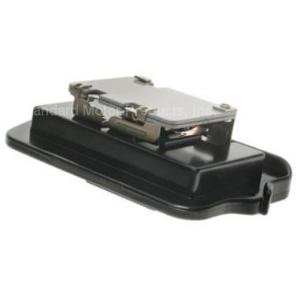

WheelBrokerAng ...picture I hope is right for all to see

Darn did not think of a picture, and its all tucked back away now. And the resistor looked nothing like the picture above. I have to chase down a short one of these days, if I tear back into it, i will take a snapshot.
