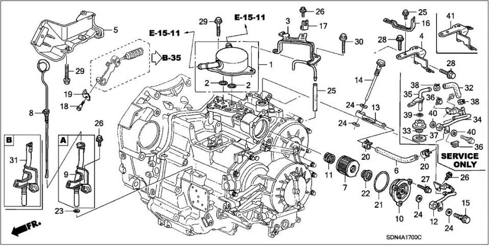

In the attached, you are looking for #8 and #12 - it is a bolt and washer.....the washer is up to you. The dealer should be able to get this for you.
#8 - 25614-PK4-000
#12 - 90441-PK4-000

On the 03 v6 coupe, the filter is inside a "cover" on the end of the trans. Some say it does not need to be replaced. See the attached pic for the location and the cover I'm speak of.....your choice.
In the pic, #7 is the filter, you can decide on the o-rings/seals (#21 and #22). There are three bolts to the cover (#10)
