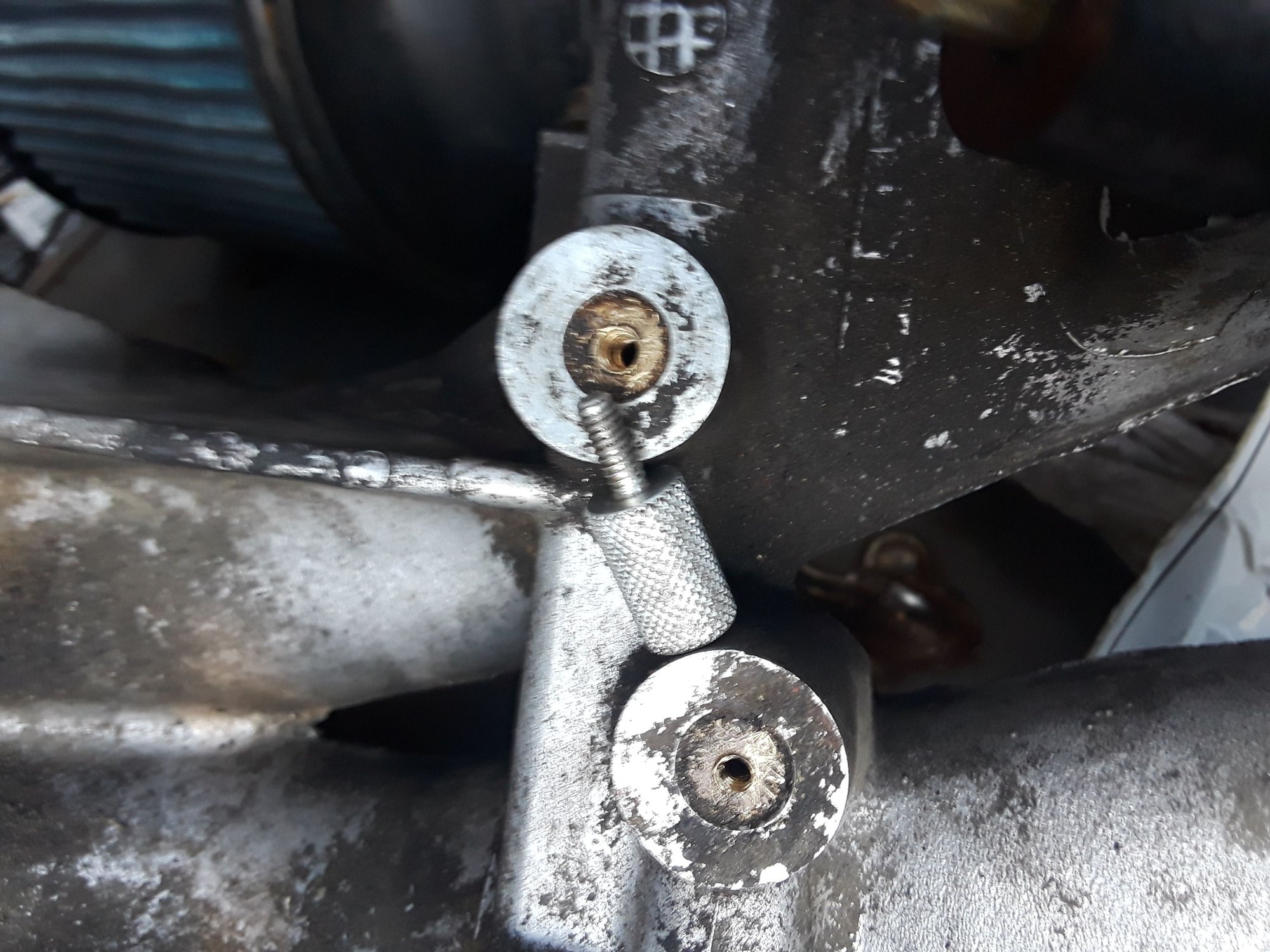

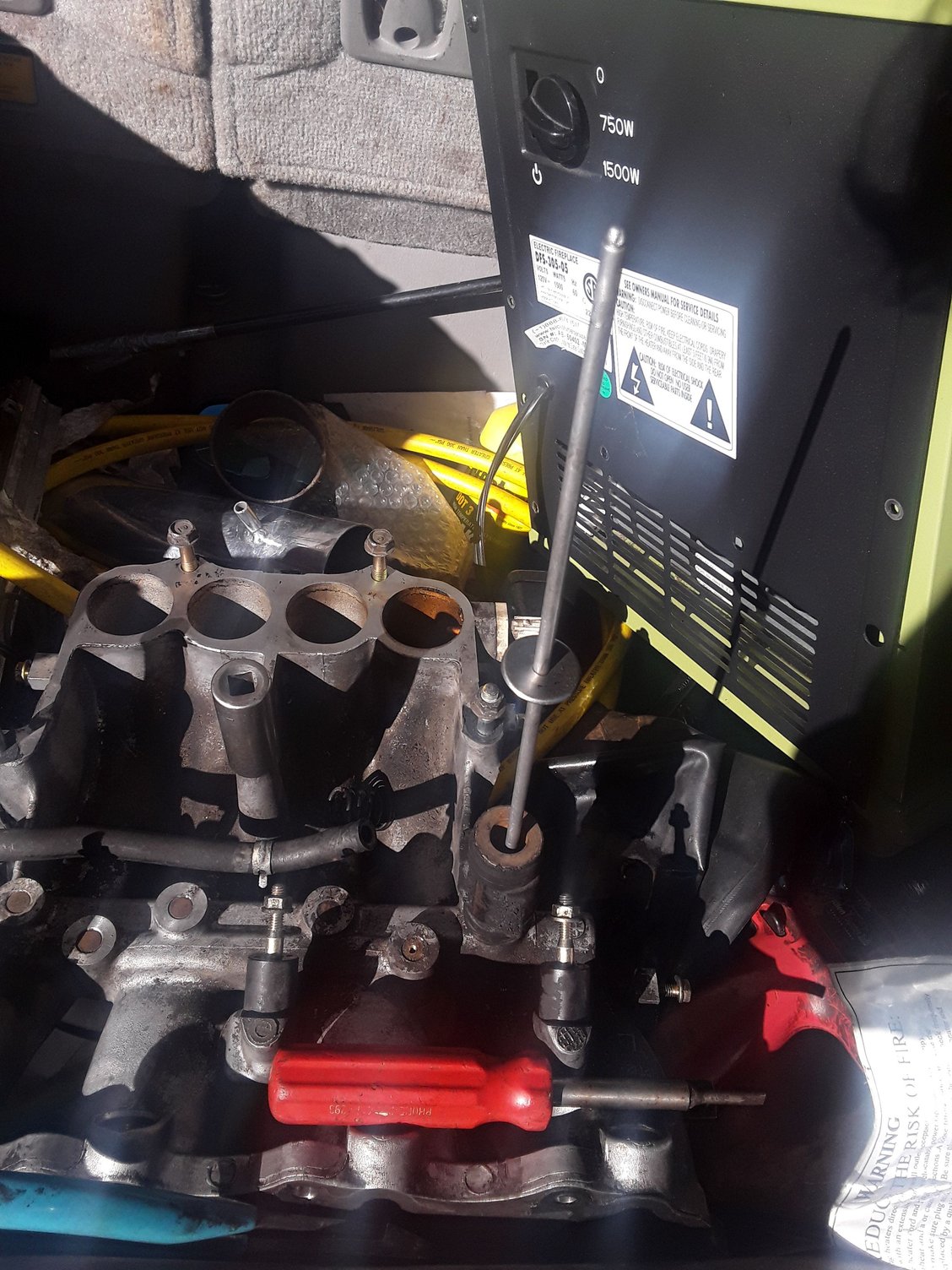

Drilled hole in first cap right to left, ahhhhhh should the bit gone through out bottom into intake? If not taking cap off and plugging bottom, there is a cap on right side, well timing belt side, of passages, drilled a hole through that one, and could send a wire to the egr end, nothing blocking path, just some blew out, ok broke a tip of a tapping tool, in hole, able to unscrew it with wire cutters, the next tapered mark was perfect for this tool PAHONDA slide hammer putting together. Thanks PAHONDA!! The cap on right is the one I sent bit through into the intake .
canals
Sent wire to rgr end, no blockage, oh i did spray quit a bit carb cleaner in that end hole first, drained out egr end.
Wire seen coming through intake.

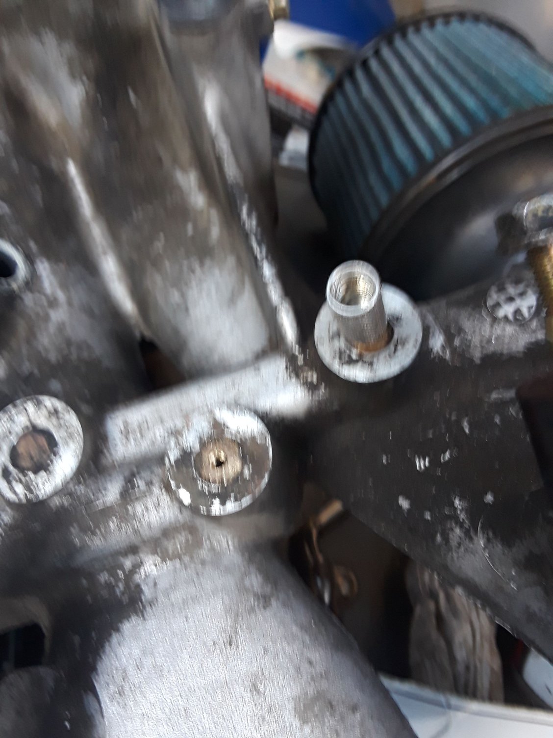

Ended up expanding holes in caps, used a long wire,, able to bend tip fish it through passages between cap and manifold, used drill,, cleaned, even from egr port, fished it through, hooked drill, cleaned, air pushed chunks carbon out holes.got all parts in, valve lapping tool and compound also. Forgot jb epoxy to fill holes in caps. The 1/4 in holes can be tapped and plugged also. So excited and anxious, didn't center first holes in caps, so cant drill out whole cap this time around. Ok new valve seals, lap, clean head and put the head on.
