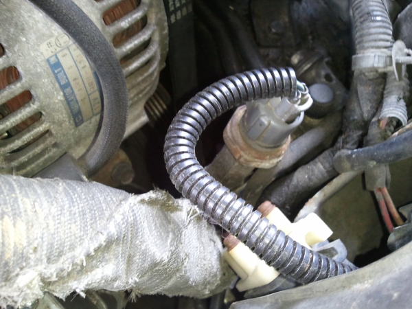

After replacing the pressure switch connector (photo below), I hooked up my gauges. Well I hooked up the low side anyway.. I was surprised to discover that the high side fitting was a smaller size than the low side. My prior AC work has been on Fords, GM and Mopar - and I don't recall ever running into this. (Adapter needed?)

"After" photo of my pressure switch:

Low 40's is about as good as it get's w/ the Accords.
thanks for followup report.
