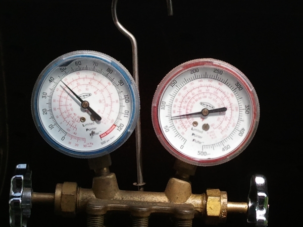

I had a chance today to check the operating pressures.
The high-side service port adapter fit just fine. But I ran into an unexpected snafu with my high-side gauge. It is reading around 350psi when it's disconnected.
I have no idea why. It does increase from that point upward when connected. Is there a zero-adjustment for a gauge like this? It is a "Uniweld". There is a screw on the face of the gauge:
