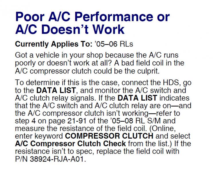

It may be due to a faulty field coil (stator set). A bunch of different model Acuras and some Honda Accords had a problem with it.

This Sept. 07 Acura Service News excerpt was related to the Acura RL; but, other Acuras also had the problem.
Attached Thumbnails A/C Not Working on My TSX-sept-07-news-excerpt.jpg

Thanks redbull. The clutch is definitely engaging. I'm assuming the coil is doing its job.
