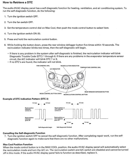

Old May 10, 2012 | 07:52 PM
See if this gets you going...03 without Auto HVAC, be sure the pic matches your control panel.
Old May 10, 2012 | 08:02 PM
This sometimes happens when the refrigerant charge is low. The evaporator does not fully cool and warm air comes out some vents w/ cold air from others.
Check for codes as PM suggests, but if nothing suggest having the AC pressures checked and system inspected for leaks.
