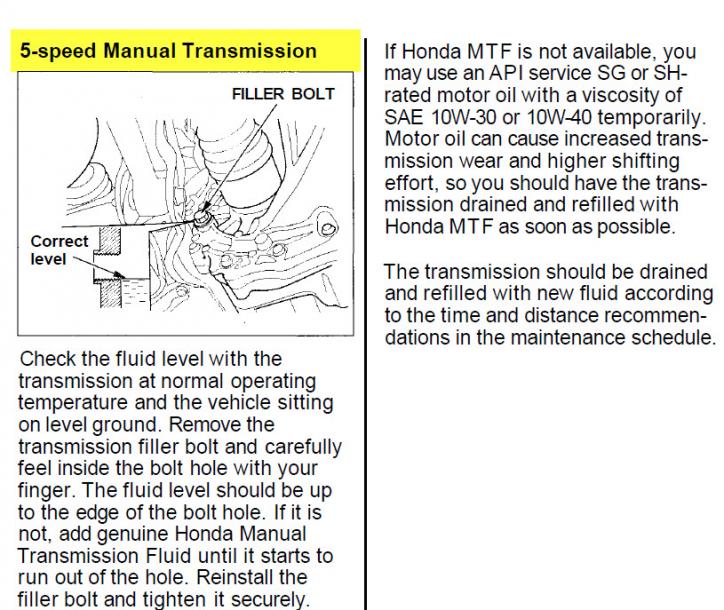

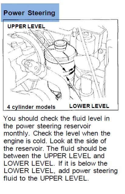

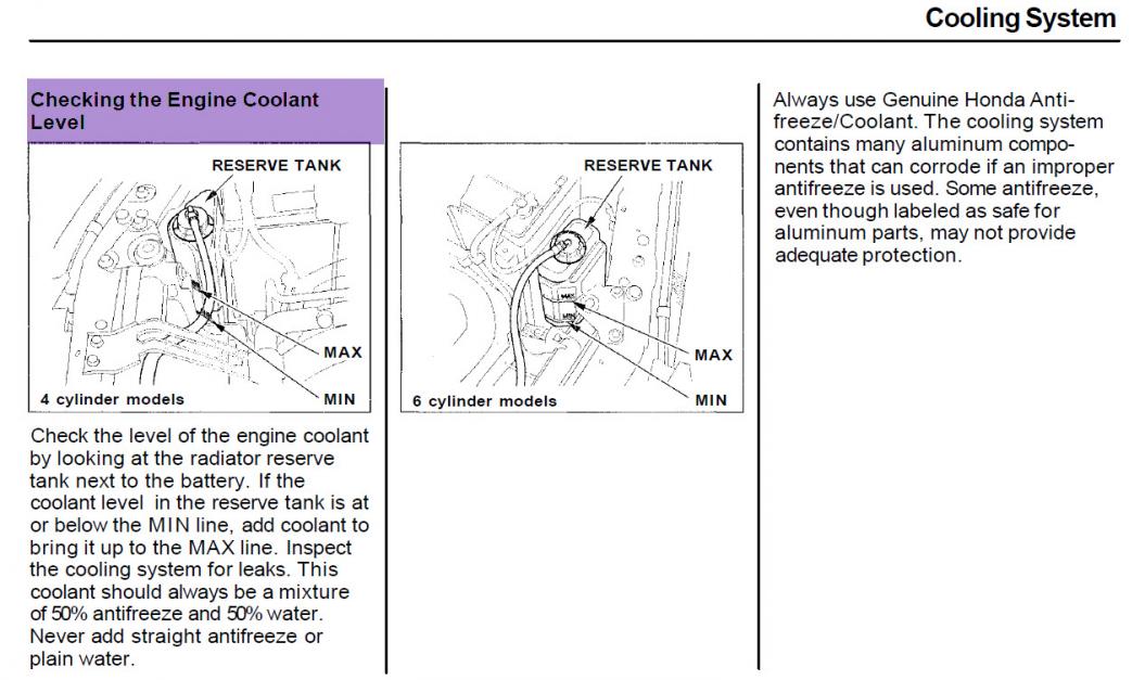

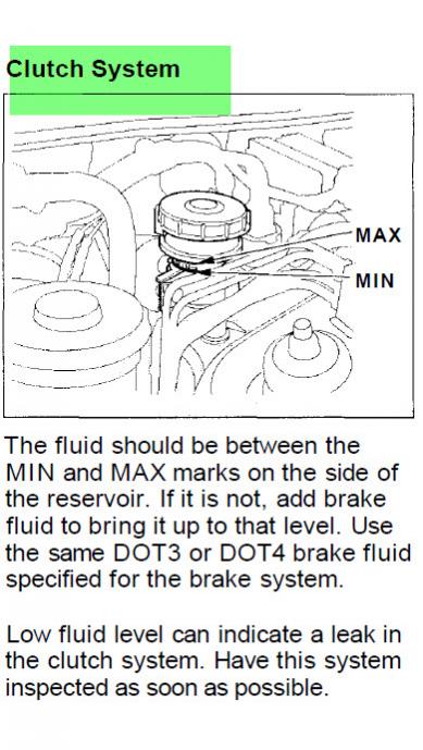

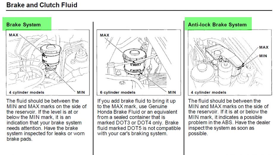

I need a online copy of a owners manual for a 96 accord ex, 2.2 vtec, with manual trans and or a diagram showing where to fill each thing under the hood also what each reservoir is for as some of them i dont recognize since this is my first honda. any links or info would be great!
I've also heard the manual trans on these are hydrolic and iassume that means there is a hydro reservoir for that?

Brake fluid - in front of driver on firewall
Power Steering - drivers side close to the front of the car, about 8 inches away from headlight

Coolant - passenger side next to headlight

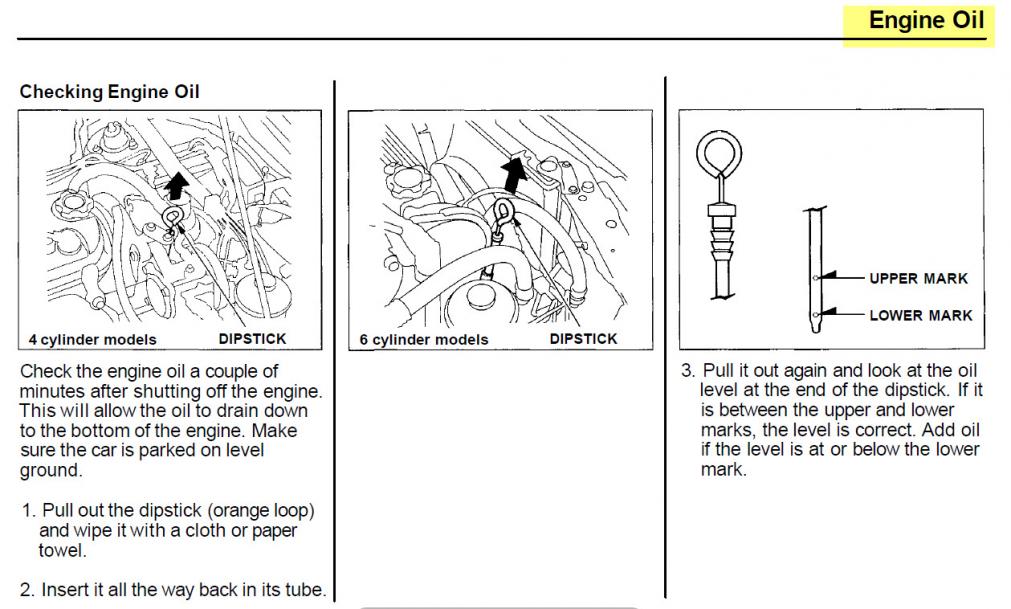

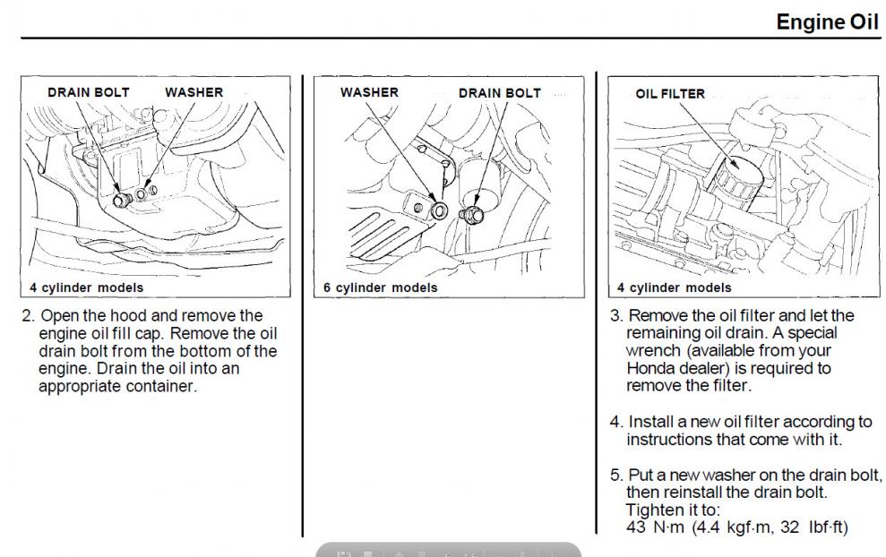

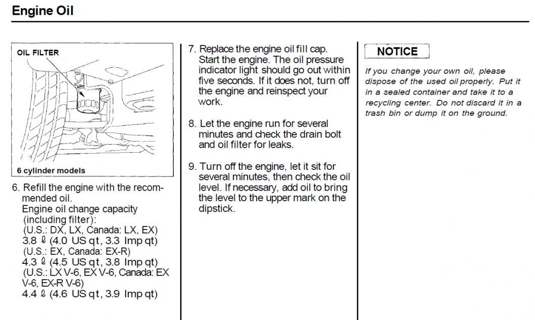

Old May 12, 2012 | 08:34 PM
Posts: 7,101
See attached pics for:
  • Engine oil
... to be continued...
Attached Thumbnails what fluid goes where?-engine-oil.jpg   what fluid goes where?-engine-oil-part-2.jpg   what fluid goes where?-engine-oil-part-3.jpg   what fluid goes where?-engine-oil-part-4.jpg   what fluid goes where?-engine-oil-part-5.jpg

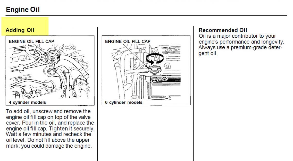

Old May 12, 2012 | 08:37 PM
Posts: 7,101
...continued...
  • Engine oil (continued)
  • Manual transmission fluid
  • Brake Fluid
  • Clutch Fluid
..to be continued...
Attached Thumbnails what fluid goes where?-engine-oil-part-6.jpg   what fluid goes where?-manual-transmission-fluid.jpg   what fluid goes where?-brake-clutch-fluid-part-1.jpg   what fluid goes where?-brake-fluid-part.jpg   what fluid goes where?-clutch-fluid.jpg

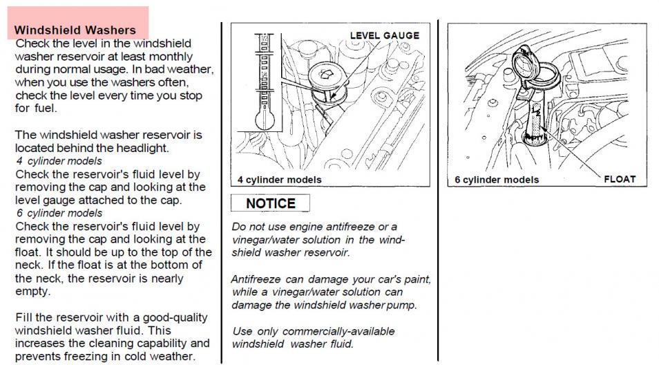

Old May 12, 2012 | 08:42 PM
Posts: 7,101
...conclusion.
  • Coolant
  • Power steering fluid
  • Windshield washer fluid
Attached Thumbnails what fluid goes where?-coolant.jpg   what fluid goes where?-power-steering-fluid.jpg   what fluid goes where?-power-steering-fluid-part-2.jpg   what fluid goes where?-windshield-washer-fluid.jpg
