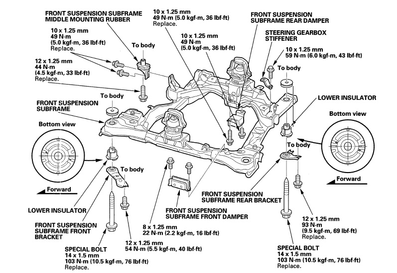

Looks like it is called the lower insulator in the shop manual. Looks like there is an upper rubber part as well that could also be damaged.
The shop manual I got can be purchased for $22 at automanualsource.com and is worth the investment for doing DIY work.
That part you bought needs to face a certain direction.
It might be easier just to remove the subframe. What kind of press tools do you have available?

They do have to be installed a certain direction. I attached a pic from the manual.
That metal piece is split, so you should be able to get it out from underneath. You may be able to use the bolt and an adapter to press the new part in. Use oil on the old bolt, put some grease on the metal sleeve and take your time so you don't strip the threads.
If the old part doesn't come out easily, you may be able to lower the subframe and slip a nut behind it. Then use a bolt and a socket from below to create a slide hammer to remove the old part.
