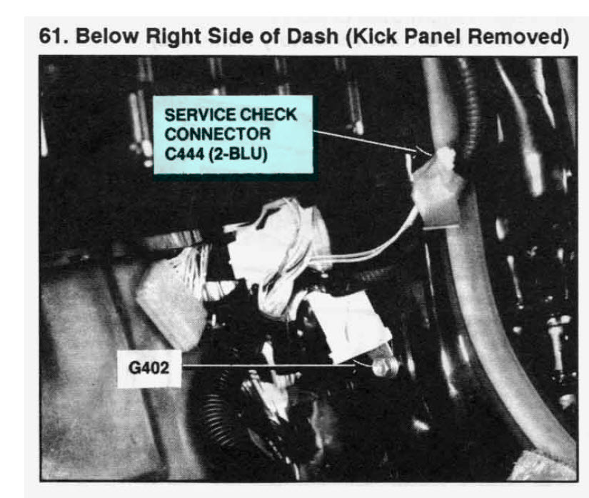

Posts: 7,101
Your car has a Blue Service Check Connector located below the passenger side dash, at the kick panel. You would use a piece of wire or small paper clip to jump the connector to retrieve any trouble codes stored.
Instructions are listed in links at the "Common DIY and Other Info. Thread" sticky, PAhonda referred to.
https://www.hondaaccordforum.com/for...l-codes-35962/
Instructions are listed in links at the "Common DIY and Other Info. Thread" stick, PAhonda referred to.
Oh **** that's handy, I'll check that out for sure and post the results
