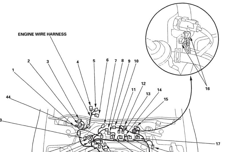

Check that the main ground (G101) on the drivers end of the TB is connected and tight. It is listed as #16 in this pic.
Attached Thumbnails Car won't start after TB cleaning: 01 Accord I4-6th-gen-g101-loc-4cyl.jpg

thanks poorman. I was actually looking at the diagram earlier in another thread you posted it in
Turns out the motor was just flooded from me trying to start it with the sensor hooked up wrong. Everything works perfectly now. Thanks!
