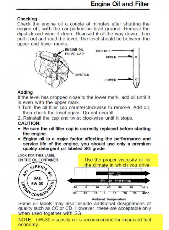

Old Jun 11, 2012 | 06:44 PM
5W-30 is the recommended oil viscosity for your 4th generation Accord. See attached.
Fram is okay if you regularly change it and not do extended drain intervals. I used Fram for years when I was younger without a problem. Now, I just buy and use genuine Honda and Toyota oil filters at bulk discount prices. At bulk discount prices, the price difference is pretty small.
