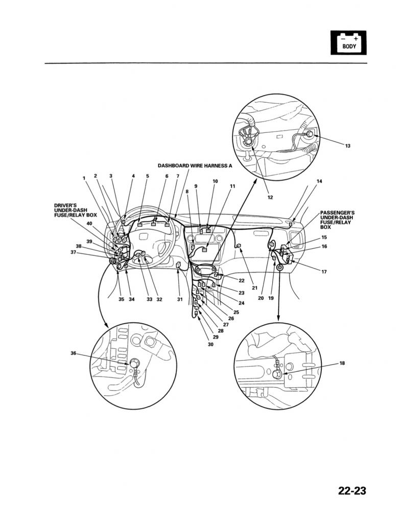

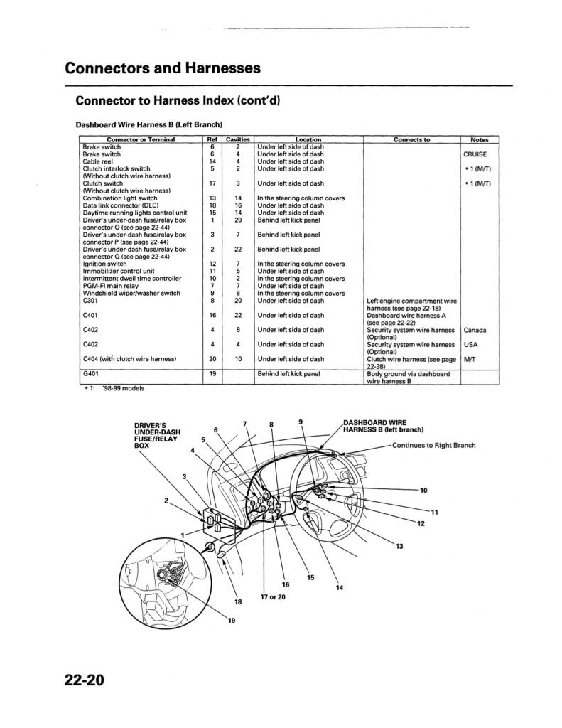

From what you described the ground is either g401 or g501. The locations are in the pics. Make sure they are not lose or corroded.

great! thanks for the pictures, will check all body ground connection...
