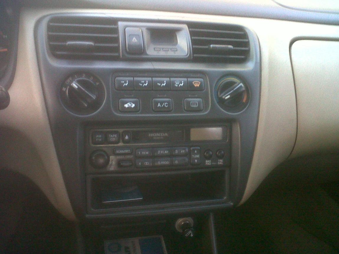

The center panel instrument having loss of power somewhere, this happen most of the time when I turn the AC but not immediate it will turn off (all the light) after couple of miles on the road, it will disengage the compressor but the fan is still blowing. Then it will fluctuate several times, I’ve already check all the fuse and the connector and wire that connect on the panel but all are intact, no idea what is wrong, please advise.

i though this problem has been solve but not until last week, it happened again almost every trip. last weekend i've check all wiring and possible ground wire that was loose but seems all intact, im lost need some advise...
is it the battery?
Old May 10, 2014 | 09:05 AM
Many of these in the US had an issue with the PCB in the hvac unit.
There are some write ups where people added a jumper wire and solved the issue?

thanks for the link poorman212, problem solved!
and thanks for Alimaxor for the picture...
