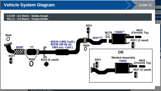

After actual inspection of the situation I discovered the exhaust leak is because of holes rusted through the exhaust pipe(s) in a couple locations, one in the area just around/behind where the exhaust hanger part number 8531 is shown in this diagram:
The other rusted area is on the other long pipe, part #68336 in the diagram above, in the area of its hanger.
I noticed the rear rusted pipe on my car is part of a (factory) welded "assembly" along with the muffler (as shown in the diagram). So it seems I have a couple of options in regard to replacement if I buy parts through my local auto parts store. I could either get the individual parts (muffler $81.00, pipe $35.99, gasket $2.99, and clamp $1.79) for a total of $122.76, or I could get another welded assembly (assembly $167.99 plus $2.99 for another gasket) for a total of $170.98. If I went the individual parts route (muffler and pipe separate) I could save $48.22. Is the $48.22 savings worth the extra trouble it might take to replace the muffler and pipe separately instead of going the "welded assembly" replacement route? Any opinions/comments appreciated about that.

Old Dec 27, 2014 | 07:20 AM
  #28
I've gone both ways on the pipe/muffler question on some of my old 3rd gen's. So for the ~$48, I'd go with the pieces.
The cat should be fine. I would look to see if you can fashion something for the shield. I think some places use to carry replacement shields. If the shield is still somewhat there and just the mounting has come loose, some have used large hose clamps - or other types of clamps - to secure it back to the cat. Usually doing this to keep it from rattling.
Since all of this is post cat - time is on your side. If you/she can handle the noise, you can do this when you want.

Yeah we can handle the noise, which really isn't bad at all yet. Kind of just really bugs me though seeing the exhaust leak from underneath the car underneath the cabin while car is warming up parked/idling . That "B" or "long" pipe (the one with the resonator I guess it is) seems rather spendy, and actually since time is on my side will probably go ahead now and spend some of that time trying to track down a better "deal"/option on cat-back replacement for the car. Won't consider replacing the cat if it's just not necessary. thanks poorman212
Old Dec 27, 2014 | 11:06 AM
  #30
Again, leave the cat. If the heat shield is loose and not totally eaten away there are large clamps you can get to hold it together to keep it from making noise. If it is loose and not making a noise....forget about it until you start to hear a "metal on metal" rattle on cold start ups.
Yes, I would look around and see if you can find a deal or better deal on the parts. Shipping bulky items might be an issue ($'s) but you have time to check all of that out.
