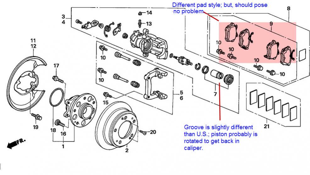

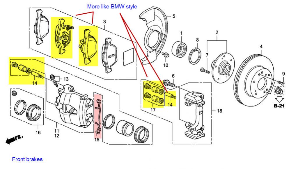

For those curious, here are pictures of the brake parts diagrams for a UK 2003 Honda Accord 2.0L Executive. It looks very manageable. The rotor (disc) removal looks similar to U.S. style.
The front brake caliper bolts and pads look like what I've seen on BMWs. The rear is more like U.S. Hondas except for the pad style and the groove on the piston.

On the front, the caliper spring looks like what Saab uses. Take note of the position - take a picture of it before taking it apart. It's possible to get that spring onto the wrong side of the tab on the caliper bracket. If you do that, your brake pedal will go to the floor & have to be pumped up every time you apply the brakes.
For the rear brakes, I agree - I think you have to twist the pistons to retract them into the caliper (like USA). Don't press them in with a C-clamp.
