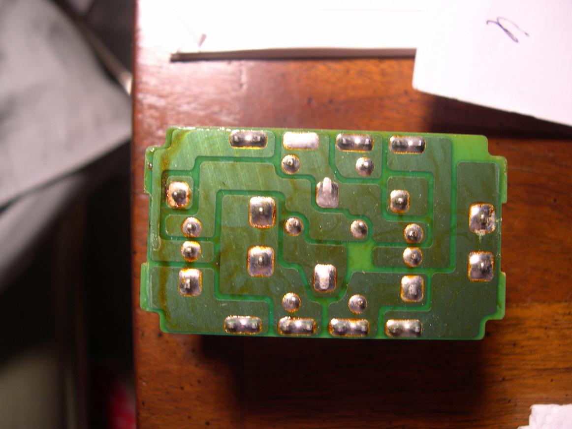

I got it out and inspected it. It looks OK to me but I don't really know what I'm looking for. Will try to post a pic and ask what others see.

Can anybody tell me how bad this looks to the educated eye? This is my main Relay.
Attached Thumbnails checked solenoids and disconnected battery now cranks won't start-dscn2202.jpg
Old Jul 11, 2011 | 06:53 PM
The cracks are very fine and around each component leg. To see whether there is separation will require a powerful magnifying glass.
Suggest you just re-solder all of them, adding a bit of fresh solder to each joint.

Search viIZ8k60awY on YouTube. It is a video on dealing with soldering the main relay. He shows the style of relay you have later in the video.

If that's Dave the car guy I did see it. It's one of the reasons I thought I could handle it, and the main reason why I removed the relay itself instead of the whole box.
