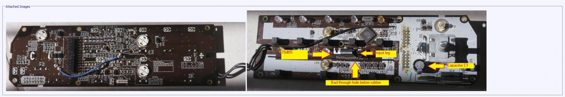

For some reason that link is dead. I found bits and pieces of info from other sites adn put them together for you. Basically, on the underside of the climate control board, just jumper the input (leftmost) leg of the78dl05 voltage regulator in the middle of the board to the positive leg of capacitor C1. That's it.

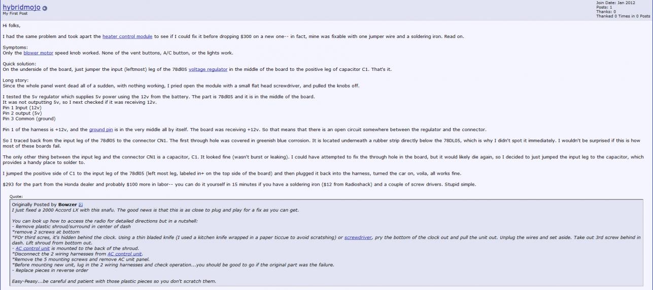

Old Sep 20, 2013 | 11:44 AM
Posts: 7,101
These are images of that person's post from the link.
Attached Thumbnails Climate Control Blinks then Dies-hybridmojo-post-part-1.jpg   Climate Control Blinks then Dies-hybridmojo-post-part-2.jpg

The link to the other forum is in my post. The post in the thread is #13, and the guy did a great job detailing the procedure. Just checked the link and it's still good.
