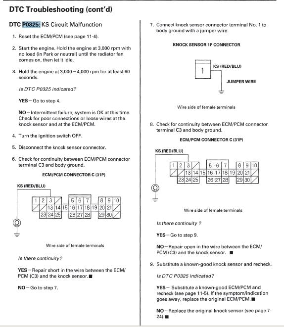

Are you able to do some checks from the ECM/PCM C3 terminal and the knock sensor?
Old Jul 5, 2013 | 11:20 PM
wade9233's Avatar
Joined: Jul 2013
Posts: 4
Yea i can do any kind of test. What test would be good to help me rule some stuff out?
Old Jul 6, 2013 | 09:00 AM
From C3, basically you disconnect the knock sensor and check for continuity to ground - should not have it.
Then use a jumper and ground the wire that goes to the knock sensor and retest for ground at C3 - it should have ground.
While you have the wire off - be sure to check the condition of the connector.
