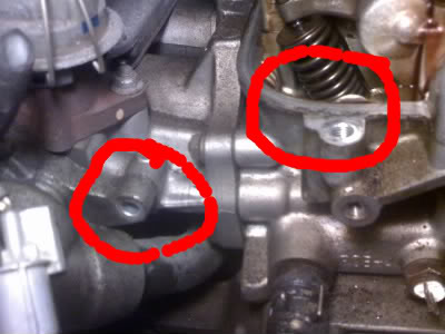

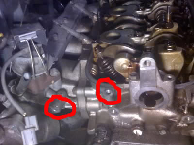

So I've got this 93 LX with an F4 motor in it. I'm pretty sure they've put this motor in and that it's not factory. They've had some issues with it, and I picked it up pretty cheap. What I need is someone to tell (and or show with a good photo) where the coil is supposed to be mounted. It was just lying beside the distributor on the top of the motor. I think the bracket hooked to it is broken and I can't for the life of me figure out where it's supposed to be. Thanks in advance for the help!!

I don't have a pic, but it should be on a bracket behind the distributor and on the left side of the EGR valve.

The vertical bolt goes into the head and horizontal bolt goes into the coolant thinger...

Pics coming in a minute, pshepard8, I'm sending the bracket with as well.

Here's the general area:
Here's the zoomed in bolt locations:
