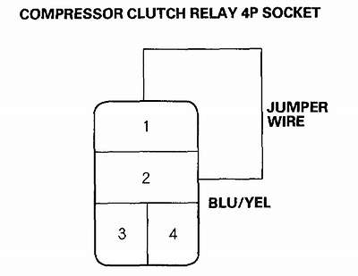

Who told you it was bad? The compressor won't run if the refrigerant is empty or low.
You can do a quick test of the clutch coil by removing the clutch relay in the underhood fuse box and jumpering terminals 1 and 2 together, engine OFF. If there is a click, the clutch coil and the wiring to the clutch are good.
here is the relay diagram:
