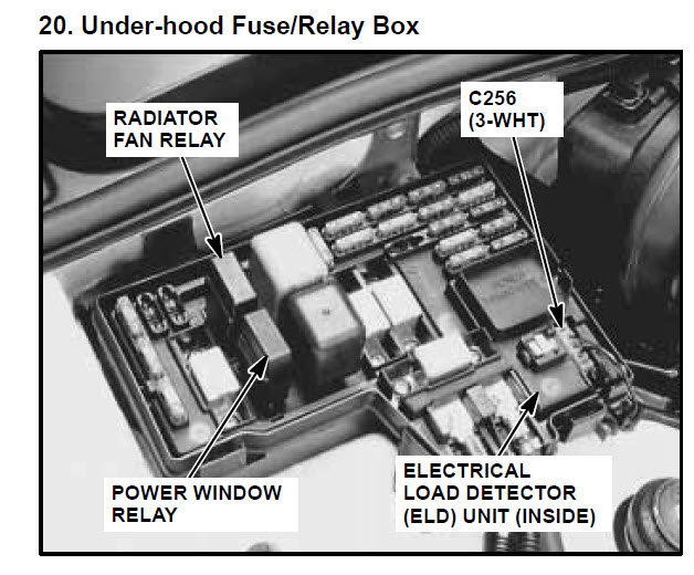

1. Check Fuse 21 (20A) located in the under-hood fuse/relay box.
2. If fuse is good, swap the power window relay with the radiator fan relay and see if it makes a difference. See attached pic.

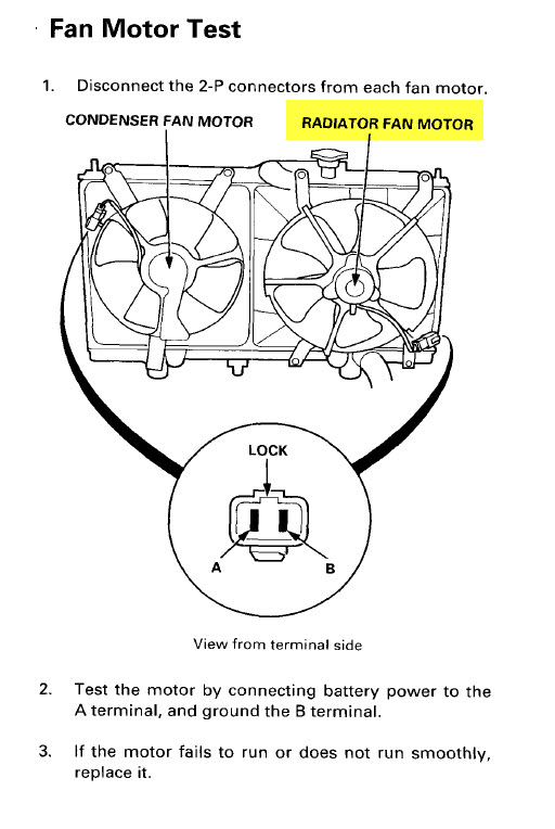

3. If radiator fan still doesn't run, check the fan motor by applying direct power and ground. This may be a little difficult to do, as the connector plug for the radiator fan is located near the bottom of the car. In addition, the plastic splash shield at the bottom of the car gets in the way when you're under the car.
Unplug the radiator fan connector and apply direct 12 volt power and ground to the connector. See linked pic. This way you can tell whether the fan motor is good or bad. You can use long wire such as speaker wires, etc. to run from the car battery or if you have a 12 volt lantern battery lying around, that works too.
