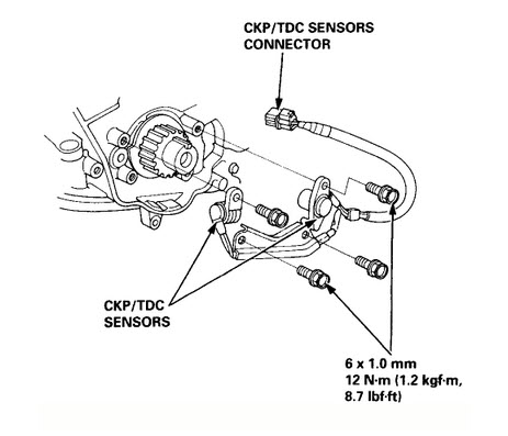

Ok so I checked the codes and I get code 8 after it stalls which is the TDC sensor.
Old Sep 15, 2013 | 02:02 PM
Posts: 7,101

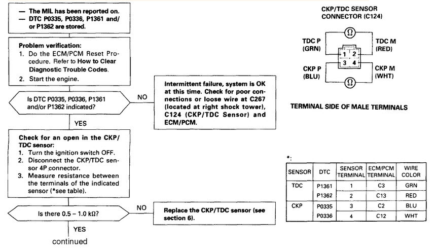

On your 96, the Crankshaft Position/Top Dead Center (CKP/TDC) sensor should be located just below the crankshaft, fastened to the oil pump housing. First, check that connector C124 terminals and wiring are okay (see pic. of C124 connector.
Attached are also troubleshooting steps.
