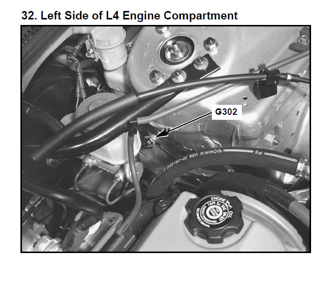

For the wipers, check the No. 12 (30A) and the No. 7 (7.5A) fuses located in the driver's side under-dash fuse box.
There is an intermittent wiper relay in the system (located in the left rear of the engine compartment, near the brake master cylinder); but, that should not cause the wipers to not work like what you're describing.
Check ground connections at G401 and G302.
Attached Thumbnails Confirmed Fix -1999 Accord has non working Wipers, Parking lights, and cruise control-ground-g401.jpg   Confirmed Fix -1999 Accord has non working Wipers, Parking lights, and cruise control-ground-g302.jpg
