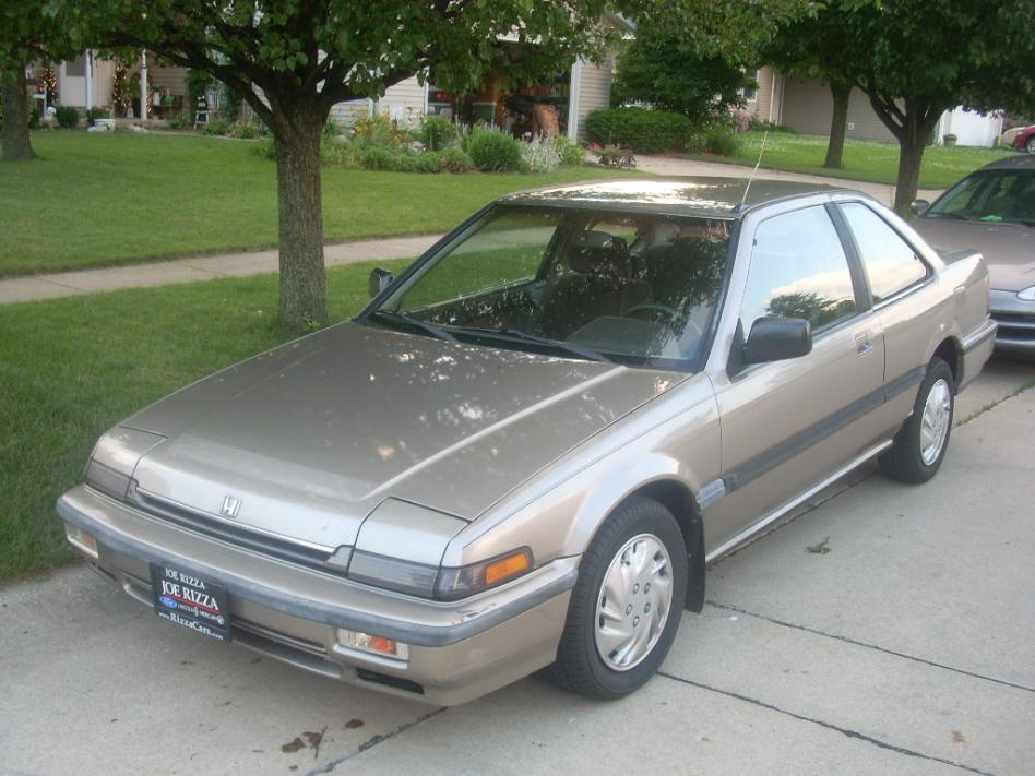

Zarckas
Default Blown Hose
Yep that hose underneath the distributor just blew on me 3 days ago, i thought it was the waterpump going out at first. but then i pressured tested it and the hose just went on my 1989 Honda Accord lxi coupe.
