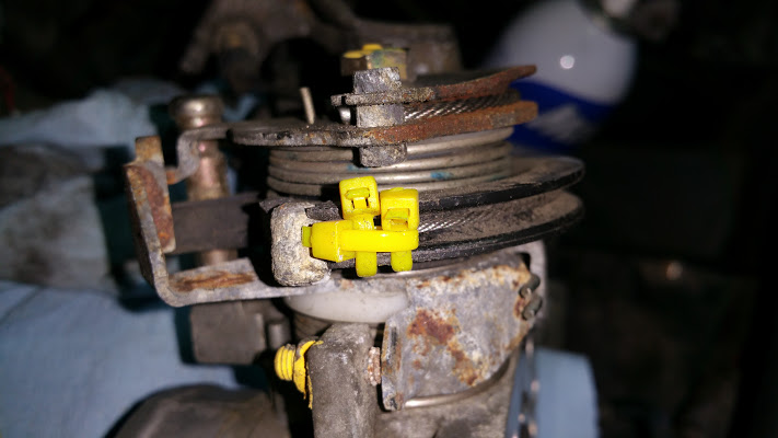

found the cable end for cruise control was hanging out there...will have to remove the TB and try to fix it without replacing the TB. poor design on Honda's part, unbelievable.

its the same issue that everyone has had where the plastic thing that holds the cable is broken.
some people have epoxied the end of the cable ball into the plastic thing...this will restrict the cable end from turning when its pulled on, isn't that going to restrict or break something else?

I fixed the cruise control! here is a pics and video of how to do it...thanks to cowsarered suggest fix!
here is the video link
