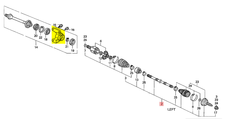

I'm looking to replace both of the front axles on my car. Here's what I've got:
  • 96 Honda Accord EX
  • 2.2L VTec L4
  • 5 Speed Manual
I've tried ordering online in the past and had bad results.
The driver's side was in desperate need of being replaced (lots of clicking on turns) so I ordered this part from Amazon:
Amazon Amazon
As it turns out, that isn't the right part as the part I need has a mounting bracket near the middle. I've attached an image of an exploded look at the axle I actually need. I've highlighted the mounting bracket in yellow to show what I'm talking about.
I've found the part number to be Honda Part No.: 06444-SV2-507RM if that helps at all.
Anyone know where I can get one of these and not have to wait 4 months for it to be shipped?

I'm confused. Is the CV joint (#2) or the intermediate shaft (#14)? What is wrong with that bracket?
The CV joint is #2 in the parts diagram.s #6/7 can be pulled from the bracket you highlighted. Looks like the bracket is sold as an assembly for the intermediate shaft (#14).

I have the entire assembly. As far as I know, there is nothing wrong with the intermediate shaft.
The reality is that I'm not super familiar with how axles work or how they're sold, so I didn't realize that the two were separate parts.
To make sure I've got this, I should be able to buy the CV Joint (#2) and attach it to the intermediate shaft (#14) that I already have. Is that correct?
Thanks!
David
Old May 22, 2017 | 08:22 AM
That's right. You don't need #14, unless there's something wrong with the components of that assembly. Generally, the CV joints especially the outboard joint at the wheel gets the clicking noise.
