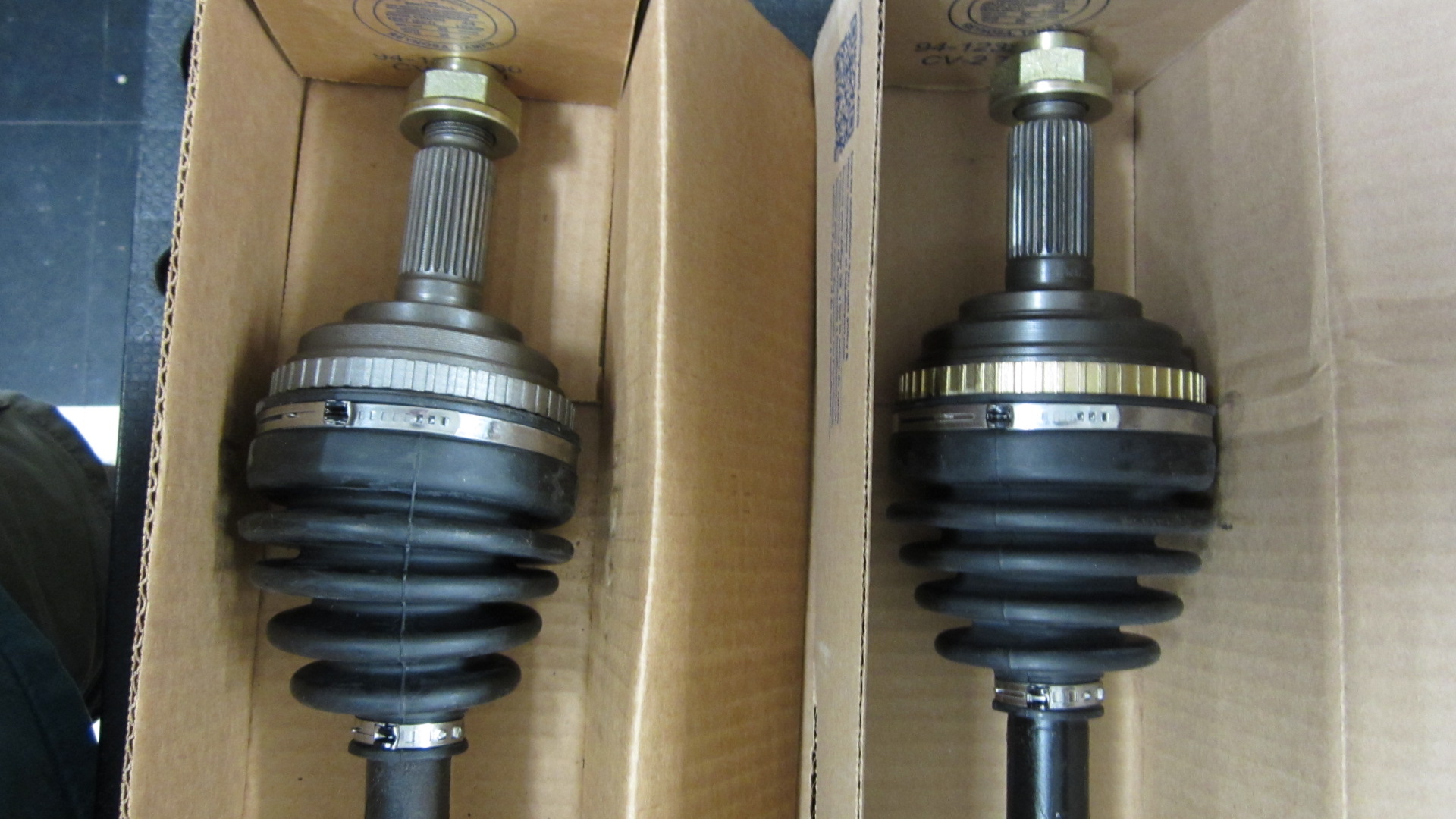

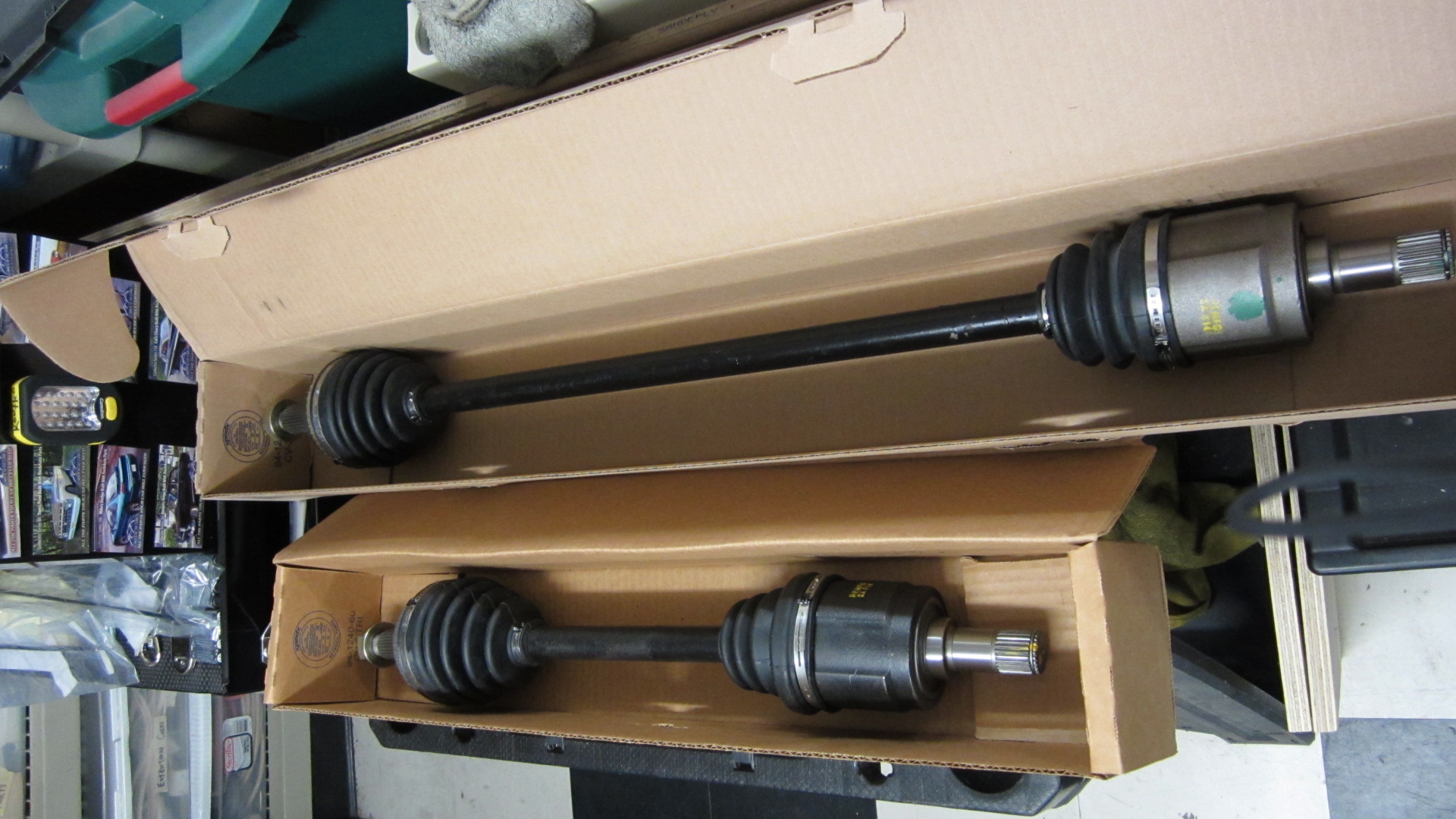

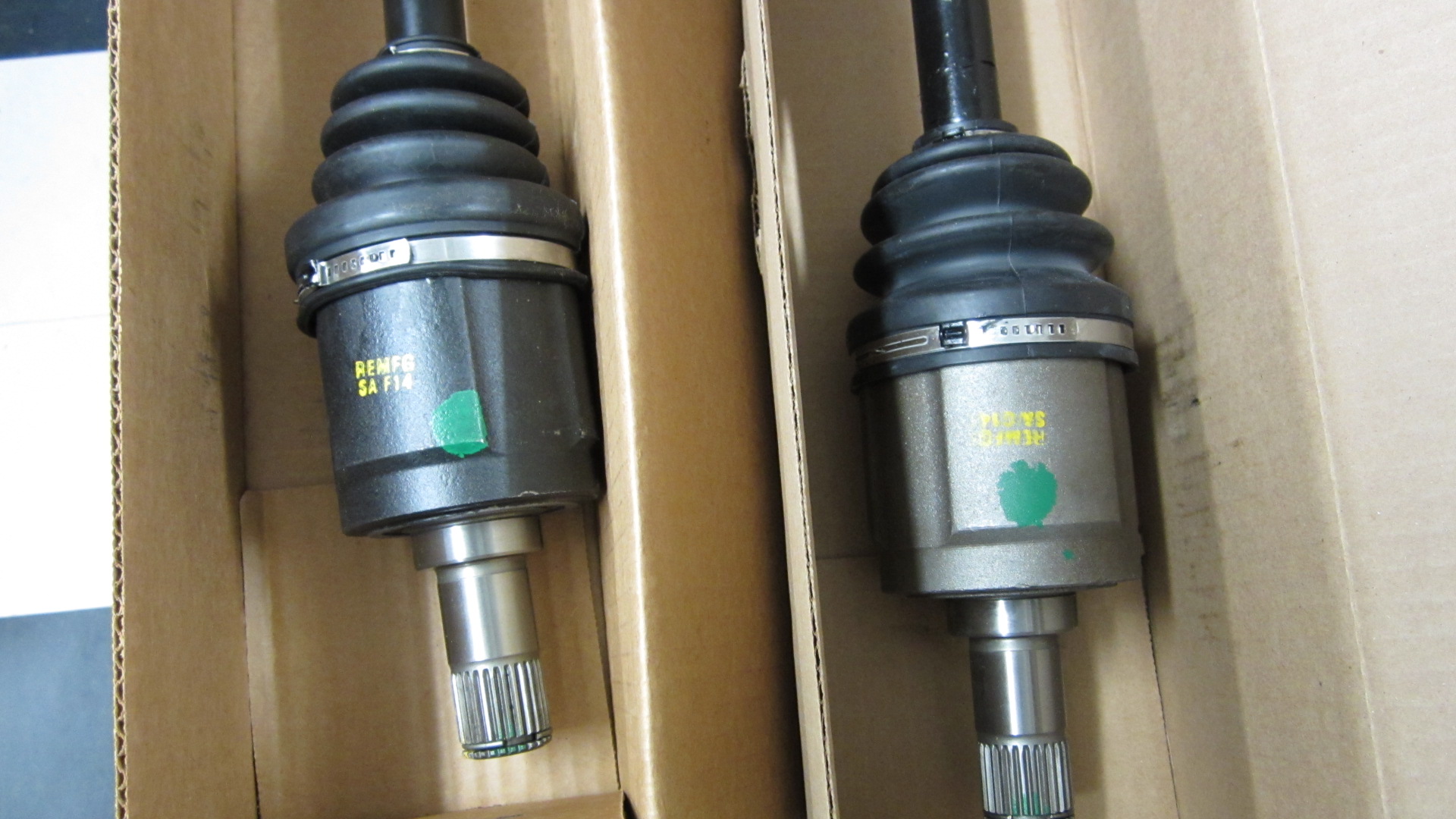

Okay, I picked up the "A1 Cardone" axles from Pep Boys earlier this evening ... this is what I got (pics below). The axles are heavy enough, nothing feels loose, the splines look clean but not new, and the shafts look a bit rough as it they had some rust on them in their past life. I could believe these are original OEM axles.
Having an OEM axle shaft is fairly irrelevant, the issue is in the CV joint. If you're not keeping the car very long, then you're probably good to go, but if you expect these replacements to last even a quarter of the time of the units which came from the factory, well...

The label on these axles suggest that the work is being done in Mexico.
Logically, assuming the same company is providing parts, then the only difference between their new axles and the remans, is that the remans will still contain some old OEM parts.
So, if the remans are failing more than the new, what would seem is happening is that the OEM CV joints are being left as-is with their current age, and may in fact be near end-of-life, whereas the new axles get non-OEM parts but they are new.
And, if a reman received a new set of non-OEM CV joints then it should be as good as one of their new axles.
