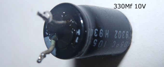

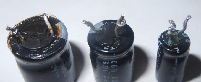

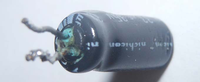

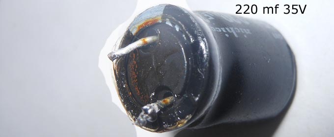

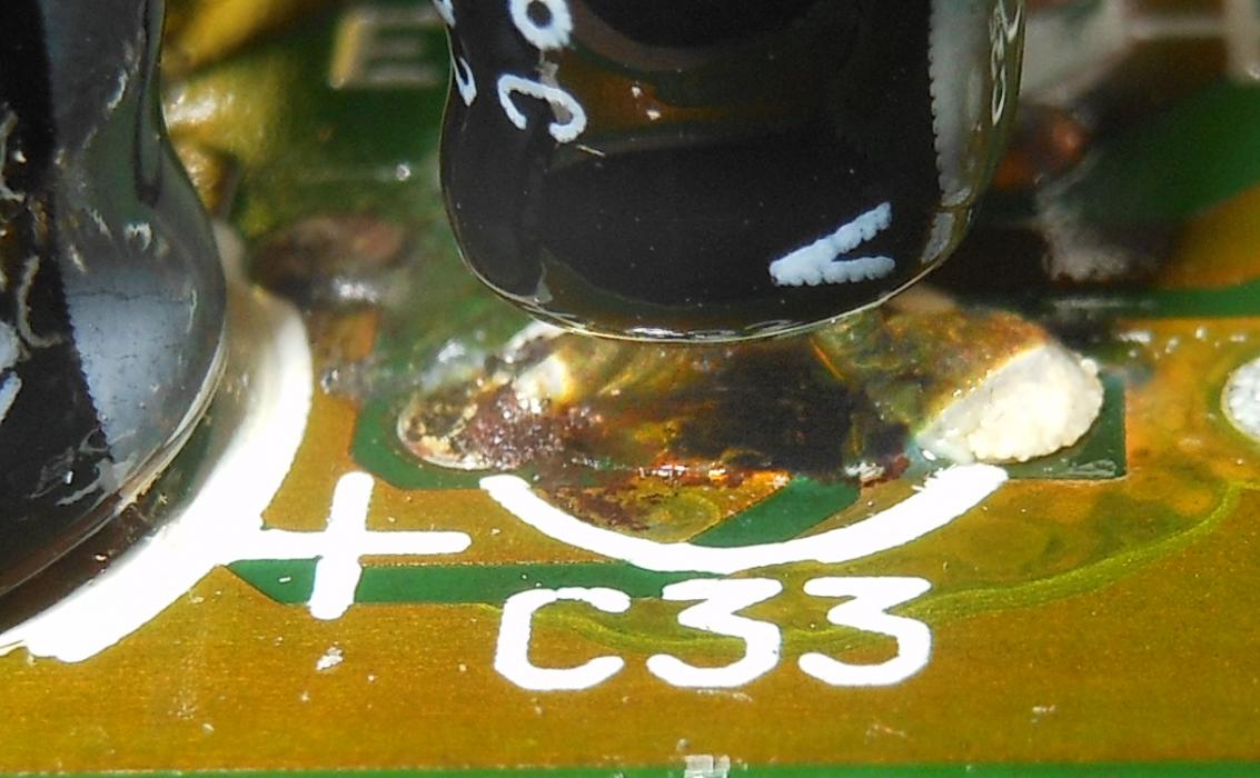

OK, I could do that - but I had looked at it pretty good before. Two things concern me... Would the leakage from the capacitor damage the board? I'm including a close up where it seems the leakage crossed part of the printed circuit. Wonder if it's beyond repair? I'm also including pix of capacitors I replaced. Two of them are bad. The other I figured I'd change while I was at it.
The other thing I'm worried about is that the guy who fixed it was not careful handling it - he had his hands all over the printed circuits. I had always understood you only handle by edges and asked him. He said as long as board wasn't grounded it's OK, and they always handle boards w/o problems. Now how do I know if more damage was done?!?
One thing I failed to inspect was the backside... first guy I asked to repair said he doesn't work on "dual printed boards" Maybe there's damage there.
Will upload images if anything looks weird...

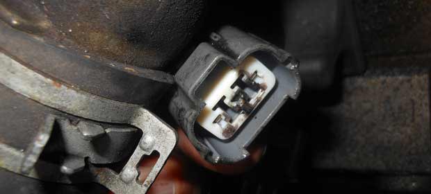

I am still wondering about that connection. I had posted a pic of it in my first post, and including again. Thing is, when I look into the connector, the metal contacts seem to be fine... The black "soot" on them is more of a stain on the plastic - it doesn't wipe off. I also noticed the same stain on the IAC connector a few days ago, so I thought it was just normal. Really haven't seen any corroded metal, but maybe I should try bypassing the connector?
The connector in question is for the shift solenoids - the lock up doesn't show any discoloration, so maybe it's not that far of a reach?
Thanks

Yea.....you might want to "de-pin" the connector - release the wires from it from the back side and inspect......you could go to a "pick and pull" yard and get a couple - should be cheap and practice on them. You will want to inspect both sides....heck now that I think about it, you can buy a new connector - male and female side. Just need a weatherproof connector with the proper number of wires.
Again, check the TCU. It could have burned the new items

Before I read your last post, I took your former advise to look into the connector. I did look at the backs and they looked kinda grimey, and I would have de-pinned them like you just suggested, but I don't know how to do that. Instead I got some quick splice connectors and bypassed the whole thing. Disconnected battery for a bit, test drove it and it work great for about 95% of the time. (by the way, the D4 light came on for just a second when I turned the key. It had never really turned off immediately after starting before this) Got home and changed the ATF with the (real, expensive) Honda stuff. The generic ATF I used before looked clean and red, and the plug had just a little bit of sludge, but no visible metal, although the level was slightly higher than the crossmarks.

There are a few different styles of connectors on these, right now I can't remember how those are set up. Some of the plastic ones "un-clamp"/open up. Some relaese from the wire side, some from the connector side.......
