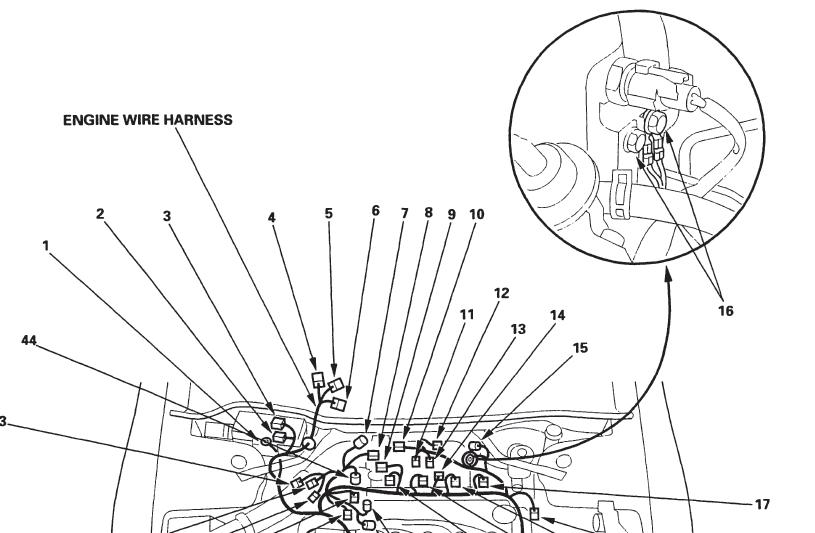

Yes, the TPS and the MAP get switched sometimes. Also double check G101-main ground for ecu- on the end of the TB, drivers side #16 in the pic.
Attached Thumbnails Did throttle body cleaning now car wont start HELP!-6th-gen-g101-loc-4cyl.jpg

Hondadude your suggestion to go back and recheck my work along with Poorman212 suggestion to check the main ground did the trick.
I noticed that I had left the main ground unattached. The car is running great and I noticed there is no longer a hesitation when accelerating from a dead stop. Thanks for everyone's input. This forum is absolutely indispensable.
