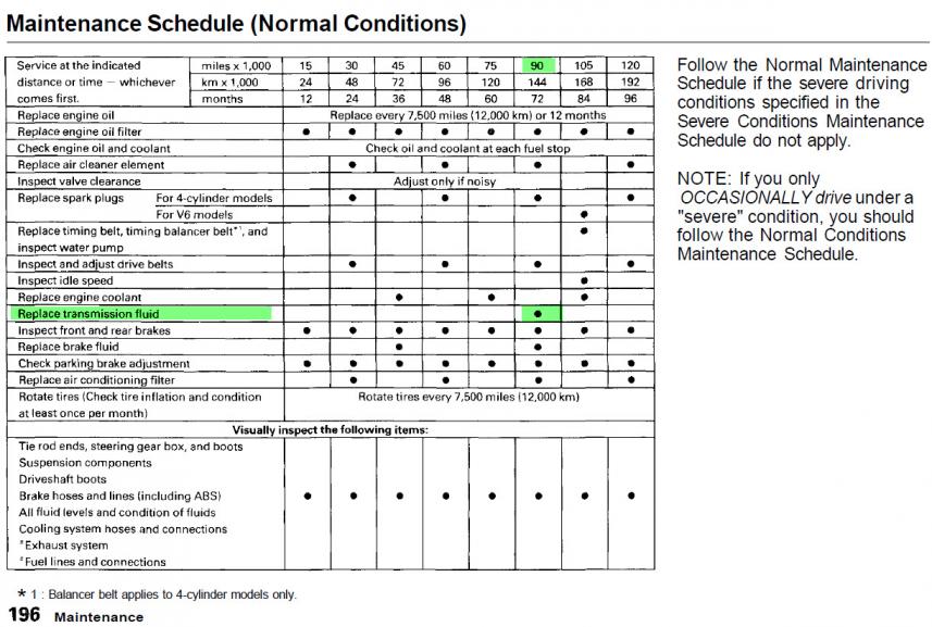

Old Nov 28, 2012 | 04:43 PM
  #18
For the OP's car, the owner's manual recommends for normal driving conditions; automatic transmission fluid by changed every 120,000 miles or 72 month, whichever comes first.
For severe driving conditions, every 30,000 miles or 24 months, whichever comes first.
I personally would not recommend that, as many 6th generation Accords were reported with automatic transmission problems, especially the V6.
I have not seen in any Honda owner's manual or service manual, of Honda recommending 15,000 miles change intervals. That is the personal preferences of some Honda owner's though. Many people change at every 15 - 30k.
Attached Thumbnails Drain and Fill question-6th-gen-accord-normal-maintenance-schedule.jpg   Drain and Fill question-6th-gen-accord-severe-maintenance-schedule.jpg
