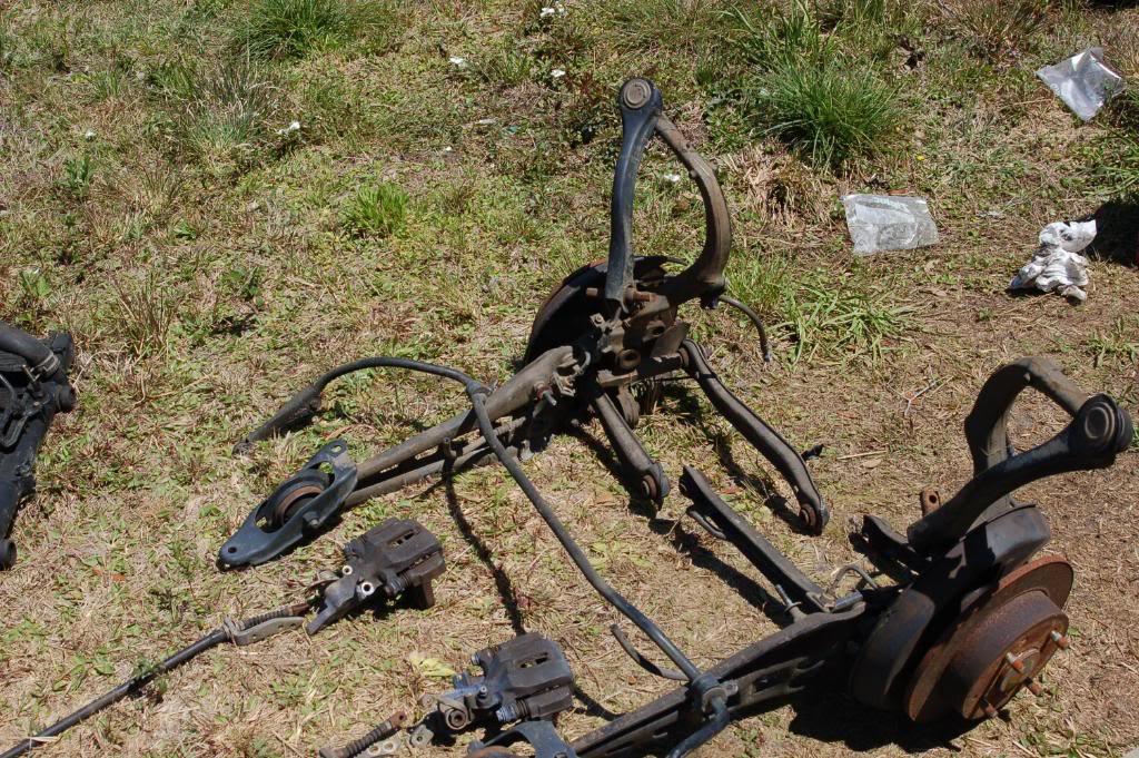

I have a 1995 accord EX with disc brakes. I was wondering If I could swap that with my 1996 accord dx. What would I need to do, the whole brake system right? Please, any inputs?

you have to unbolt the whole assembly 2geather. you need everything... you need to pull everything...all the arms that connect to the car need to come off...I mean everything...look at this pic to give you an idea of what you need...
Or you can just buy mine for 100bucks and just put it 2geather

So if I have the donor car, that means I can? How would the system hook up, just direct bolt on?

yes all 90-97 rear brake systems are swappable
