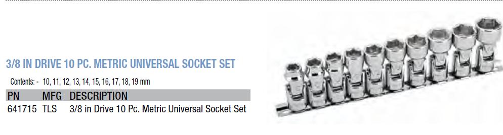

Where would one buy Swivel Sockets? I went to Autozone and I don't think I saw those.

Old Mar 5, 2012 | 05:47 PM
I'm sure there are several places that do sell them I got a 3/8 set from Sears (carftsman)-10 thru 19 but no 14 , so I got that size 3/8 made by Blackhawk, I also have 1/4 drive 8, 10, 12 made by Blackhawk....at the time carquest sold Blackhawk tools, I think they have another line now.
Found this from powerbuilt??
Good luck, let us know how it works out.

@poorman212: I'll look into those. Those may or will come in handy eventually.
