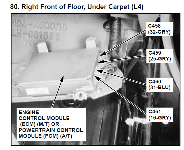

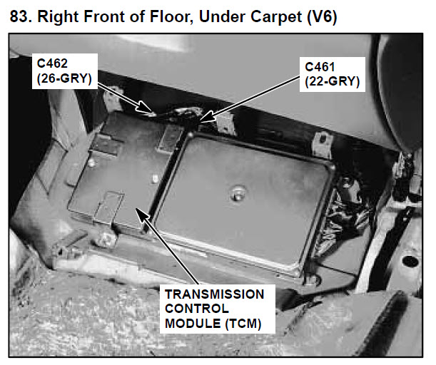

For the 1997, only Accords with the automatic came with the engine mount control system.
  • 97 4 cylinder automatic had a Powertrain Control Module (PCM) instead of an ECM.
  • 97 4 cylinder manual had an Engine Control Module (ECM) instead of a PCM.
  • 97 V6 had an ECM and a separate Transmission Control Module (TCM).
For the 4 cylinder automatic, the electronic control engine mount solenoid valve was controlled via the PCM.
For the 6 cylinder automatic, the electronic control engine mount solenoid valve was controlled via the TCM.
I would think that you can probably just plug the vacuum line.
Attached Thumbnails Engine mount control system question-l4-ecm-pcm.jpg   Engine mount control system question-v6-tcm-ecm.jpg
