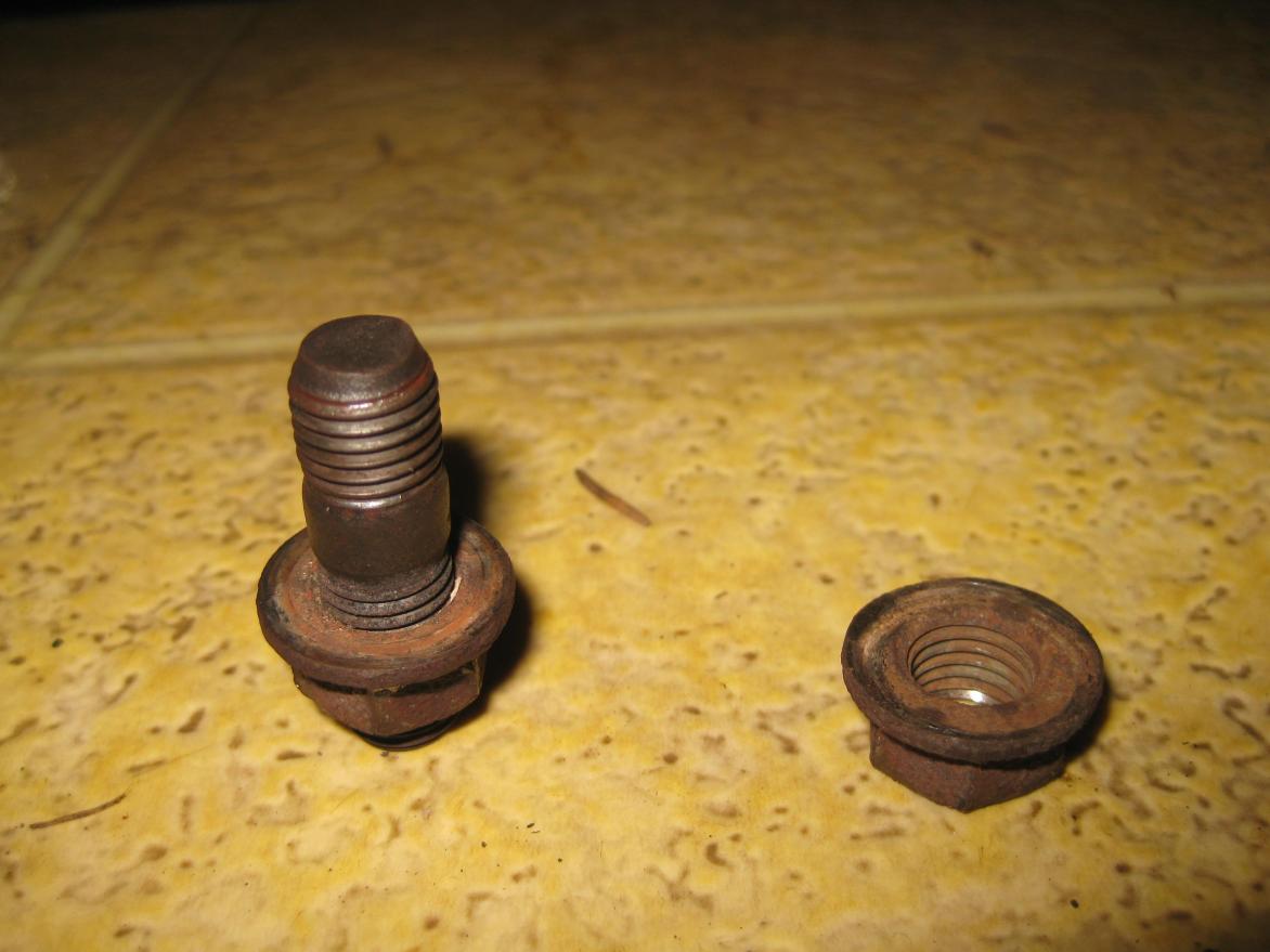

I was removing the exhaust from the manifold (see picture) and the threaded studs came out with two of the nuts (see other picture). Why did this happen? is it a problem? how do I correct it?

The nut rusted to the stud, making it easier to turn the stud in the head than the nut on the stud. It's fine. Just put anti-seize on the studs when you put the manifold back on. Anti-seize on the studs that the nuts came off of will keep those studs from turning out of the head in the future.
