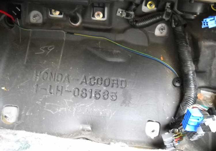

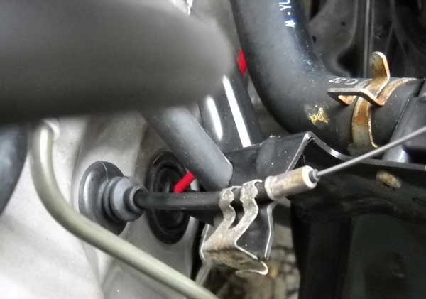

An F22B1 ECU runs my F23A1 just fine. I believe an OBD1 VTEC ECU is a P0A-A01, originally installed in 94-95 EX manual trans Accords, would fill the bill. Wiring the VTEC is easy, especially with the engine/trans out of the car. Here's pic's of my half-assed wiring job:

I just ran the wires though an existing grommet near the heater valve, which also has the (red) wire for my amp going through it. I found the pics on ff-squad(dot)com excellent for adding/removing pins from the ECU plugs.
