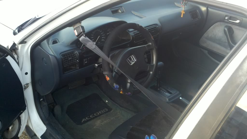

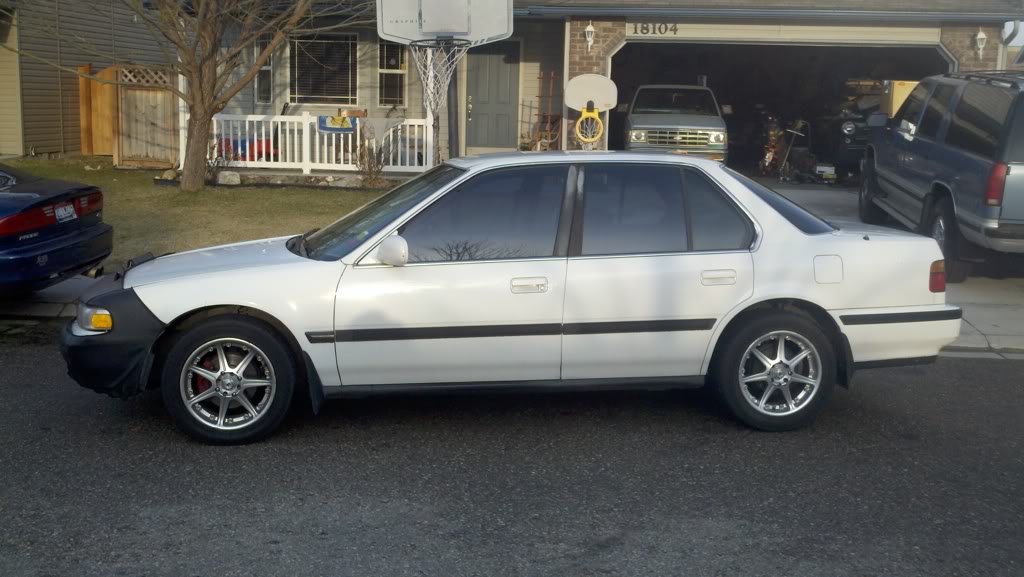

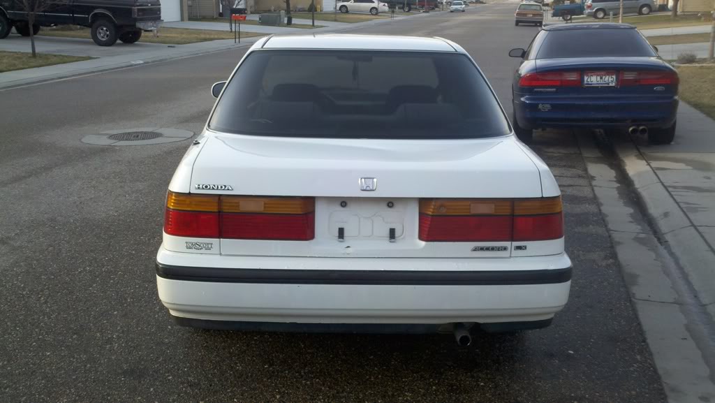

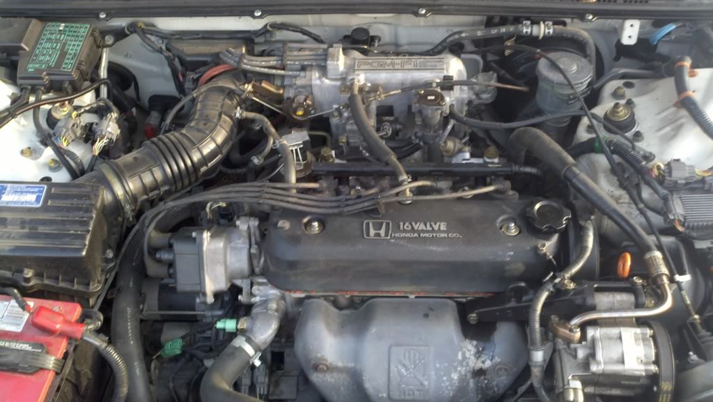

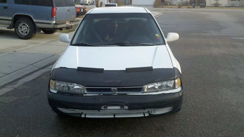

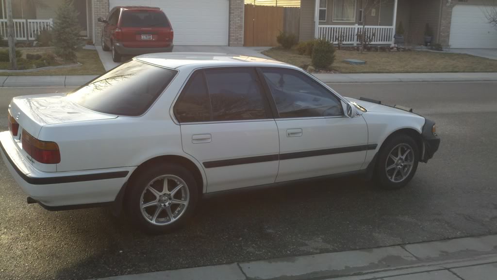

Man, oh man! So I'm trying to sell my '90 Jeep Cherokee with blown heads to fund part of an Accord. Someone offered to trade with cash on top. Here's what he offered:
'91 Accord 4dr, auto, 170k

It sure is gorgeous! But it's an automatic... And I just can't do that. It bums me out pretty bad that it's auto. However, he's a mechanic. So in my reply email, I asked him if he knew anything about tranny swaps. I spoke to him on the phone beforehand as well. Waiting for reply.
What do you guys think? We haven't discussed how much I'd throw on top. But what do y'all think? Worth buying and swapping tranny? I was thinking throwing $1,000 on top, if I could get a tranny swap done for around ~$500.
Old Mar 18, 2011 | 02:47 PM
Posts: 16,334
Converting the auto to manual can be done, but it can add up to more than $500 pretty quickly, because there are a lot of parts you don't think about when attempting to do this.
You will need from a MT accord: the clutch pedal, master/slave cyl +lines, transmission, shifter, shift cables, ECU, transmission mount (+ some welding), starter, clutch, flywheel. The CV joints may be different too. I'm probably forgetting stuff as well.
There is a writeup listing everything required somewhere on this forum. You will have to search around to find it.
Plus you are dealing with a 20 year old car that is due for a timing belt change at 180K, or 90K/6 yrs after the last TB change. Find out when the TB was last changed on this car.
I also noticed that the windows are tinted. You should find out what is legal in your state. Also the valve cover gasket was sealed with RTV. That isn't such a big deal, owner probably didn't want to buy a new gasket.
