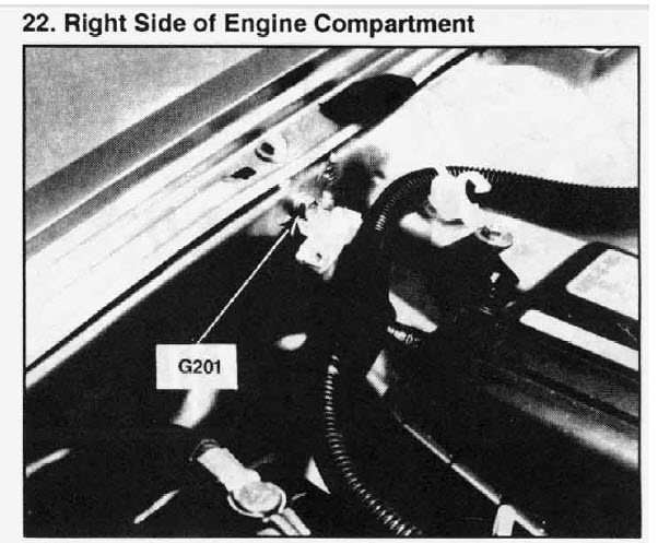

For the 92 Accord, the ground used for the left and right low beams, and right front side marker is ground location G201; located on the right side of the engine compartment (see attached pic.). Check along the ground wire and the grounding point. -- There is a high possibility it is the ground or wiring due to them sharing the common ground.
The left bumper light is probably a separate wiring or bulb issue.
Attached Thumbnails Finally got it running after two years and now no lights 1992 lx-ground-g201.jpg

well I am convinced that that ground is my issue, I will have to wait a day or two to find out tho, work first ya know
