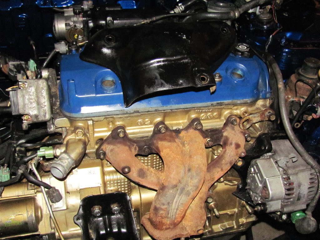

Take a look...
Also where is my o2 sensor???
Is there a way to patch the crack in my manifold or do I have to get a new one...

New or a junkyard part will work. I think the crack is probably from a flaw when the manifold was poured.
I bought an aftermarket one and it lasted until I sold the car.

The O2 is under the car, right before the cat.
If you go back stock, check that little bracket to be sure it is not broken....in the second pic, you can see the two bolts to it...one into the manifold one into the block.
