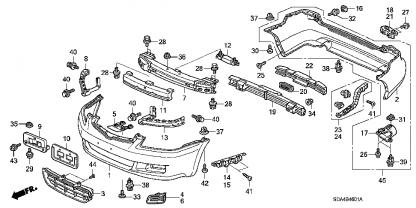

Old Feb 24, 2014 | 06:59 PM
Posts: 7,101
I haven't found a cheaper one yet; but, here are some price comparisons. I didn't include the license plate frame (#10 in the diagram), as you can use any frame with the base. Sports Chalet gives away free frames that says things like "I rather be skiing, playing tennis, golfing, fishing, etc." There's a Sport Chalet in West Jordan , Utah.
The parts I listed are #9, #35, #29, and #43, respectively in the diagram.
List Price:
71145-SDA-A10 BASE, FR. LICENSE PLATE $10.90
90675-SA5-003 NUT, CLIP (6MM) $3.35 X 2 = $6.70
90111-SM4-003 BUMPER, BOLT $2.77 x 2 = $5.54 (cheaper if you can find at local hardware store to match the clip nut)
93904-46220 SCREW, TAPPING (6X16) $.67 x 2 = $1.34 (cheaper if you find at local hardware store)
Total List Price = $24.48 plus taxes (as long as dealer doesn’t mark-up)
Without bolts and screws (Base $10.90 and clip nuts $6.70): $17.60 plus taxes
Online Honda Dealer:
71145-SDA-A10 BASE, FR. LICENSE PLATE $10.90 $7.65
90675-SA5-003 NUT, CLIP (6MM) $3.35 X 2 = $6.70 $2.35 X 2 = $4.70
90111-SM4-003 BUMPER, BOLT $2.77 x 2 = $5.54 $1.94 X 2 = $3.88
93904-46220 SCREW, TAPPING (6X16) $.47 x 2 = $.94
Total = $17.17 + $13.46 UPS shipping = $30.63
Shipping costs is high. The above example is from Bernardi Honda Parts shipped to Salt Lake City, Utah.
I think places like Majestic charges a $5 handling fee too.
So, total at local dealership is still less if they sell at list price. What you can do is call the local dealership part department and ask for a price to see if they may mark up or not, ask if they give a discount. If they sell at list or with a discount and you're okay with it, get the parts person name and then go in to buy it.
Attached Thumbnails Front License Plate help-front-license-plate-bracket.jpg   Front License Plate help-sda4b4601a.jpg
