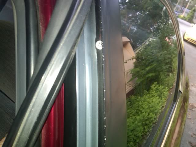

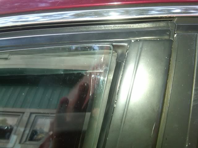

i have the manual open now, the driver side is a honda window, passenger is replacement. i pulled out the pass. window enough to see the edge of the window if i am correct the pin goes through the window, there insnt even a whole for it, also i pulled out the weather strip on the driver side, and there is no guide rail in the door for the pin. ill take pics and post them for you

Maybe there is a guide pin for the coupe. I would still do the glass adjustment. You want to loosen the bolts holding the glass. You want to pus the window up and towards the back of the car to align it.
