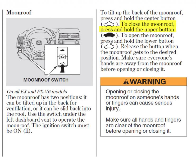

There is no automatic close; however, if you hold the switch it should close in one try. There may be a problem with the switch sending power to the moonroof close relay (e.g., corrosion, loose terminal for switch or relay, etc.) or even a faulty close relay. There are both an open relay and separate close relay, they are located under the headliner.

Redbull, thanks . . . it was operator error . . . i over-thought it.
