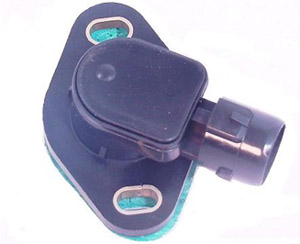

Lightbulb Could Be A TPS Angle Sensor*
Hi Member.
When these are not working properly the ECU thinks the throttle is moving and gives out little burst of fuel.
By monitoring the out put with a voltmeter onto the TPS your ECU will then be able to to tell you if the correct angle is working..check it for a broken , chipped housing..take it off if you don't have a meter and take it to an AutoZone..they can check it to see if it's getting it's 5.0 volts it should be getting..
