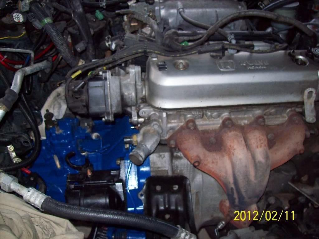

Here is a pic of my 5 speed sitting where the auto used to be and not one thing was cut or welded.

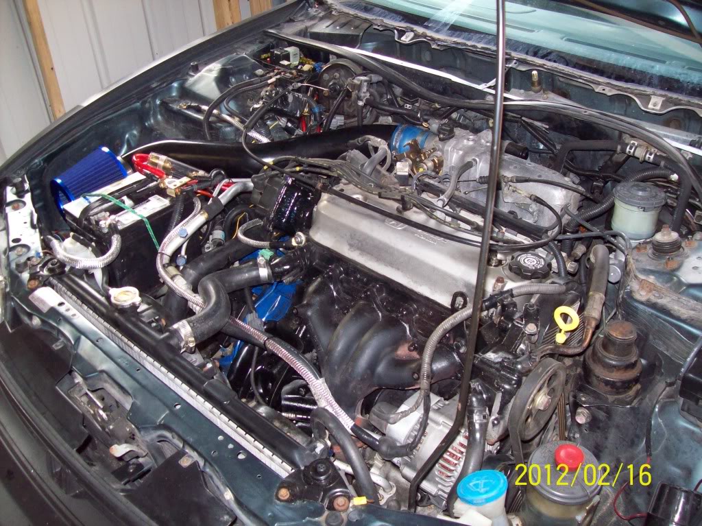

I have done about 10,000 miles since the swap, not one issue.

Crispin. Is that a new Output manifold? Or painted?
Are you talking about the exhaust manifold?
If so I just hit it with some high temp engine paint. It burns off pretty quick, I just wanted everything to look good after the swap.
