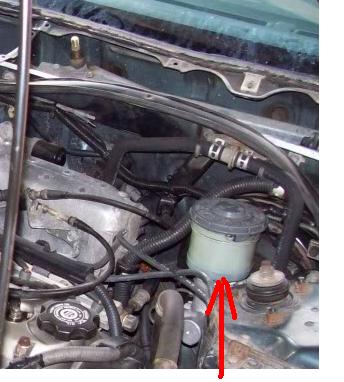

I hope the brake fluid level was addressed. I know there was still work being done on the car at the time of the pic as a few other things are out of place.
