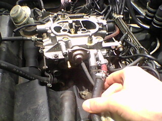

Hmm. Well. I feel dumb now.
I guess I was just used to my injected diesel, which definitely has a return line, so I assumed that the other pipe was a return line.
The first picture is of the main line, that previously had the other line "Teed" into it.
The second picture, I am pointing to what I, and the previous owner thought was the return line.
Thanks for the help

Old May 1, 2013 | 05:48 PM
That is not what I meant to do with my response.....sorry.
Can you crank the car and then look down the "throat" of the carb.....might have to work the throttle cable by hand to keep it running....while looking down the throat of the carb you should NOT see and gas - Do you?
Might PM "barnfindhonda" about the hose set up - also check under the hood for a sticker that might have the hose diagram.
Old May 1, 2013 | 10:21 PM
barnfindhonda's Avatar
Joined: Aug 2010
Posts: 17
I had the same problem when I purchased my 1984 a couple of years ago. There is a solenoid fuel cut off switch on the drivers side of the carburetor that is probably stuck half way open. I could not find the problem, had an old school mechanic diagnosis this. He opened the solenoid all of the way and disconnected it to keep it from moving. It did the trick and I have not had any problems in 2 years and 30,000 miles later.
Old May 1, 2013 | 11:57 PM
Dreamer, Seeker's Avatar
Joined: Apr 2013
Posts: 5
From: Jackson, MS
All's good.
When I crank it there's definitely gas visible in the carb.
Barnfind, I'll have to check that out, though I doubt that's it...
Dan

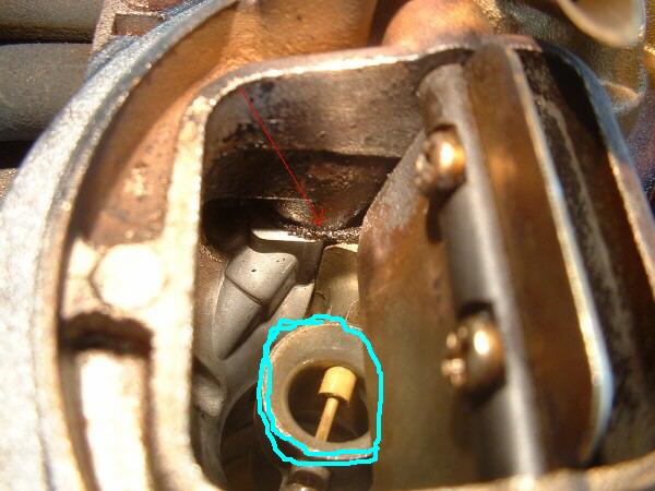

Old May 2, 2013 | 07:04 PM
If you a looking down the "throat" of the carb and see gas dripping down the throat then I'm with a stuck/bad float or the needle and seat for the float.
This pic is from one of my 3rd gen's showing where gas was dripping out of one of mine when the needle and seat for the float.
This link might give some help as well?
HONDA KEIHIN CARBURETOR REPAIR

Old May 5, 2013 | 08:34 PM
beater's Avatar
Joined: Jul 2011
You are going to have to ask" Barnfind " about the connection in your #2 picture.
I have a 89 Accord so, no help.
You need a Honda Service Manual I looked around and couldn't find one online ( for free ) but I found one on E-Bay Motors for $ 6.99 plus $ 4.00 shipping. Buy it, you will get your money's worth.
