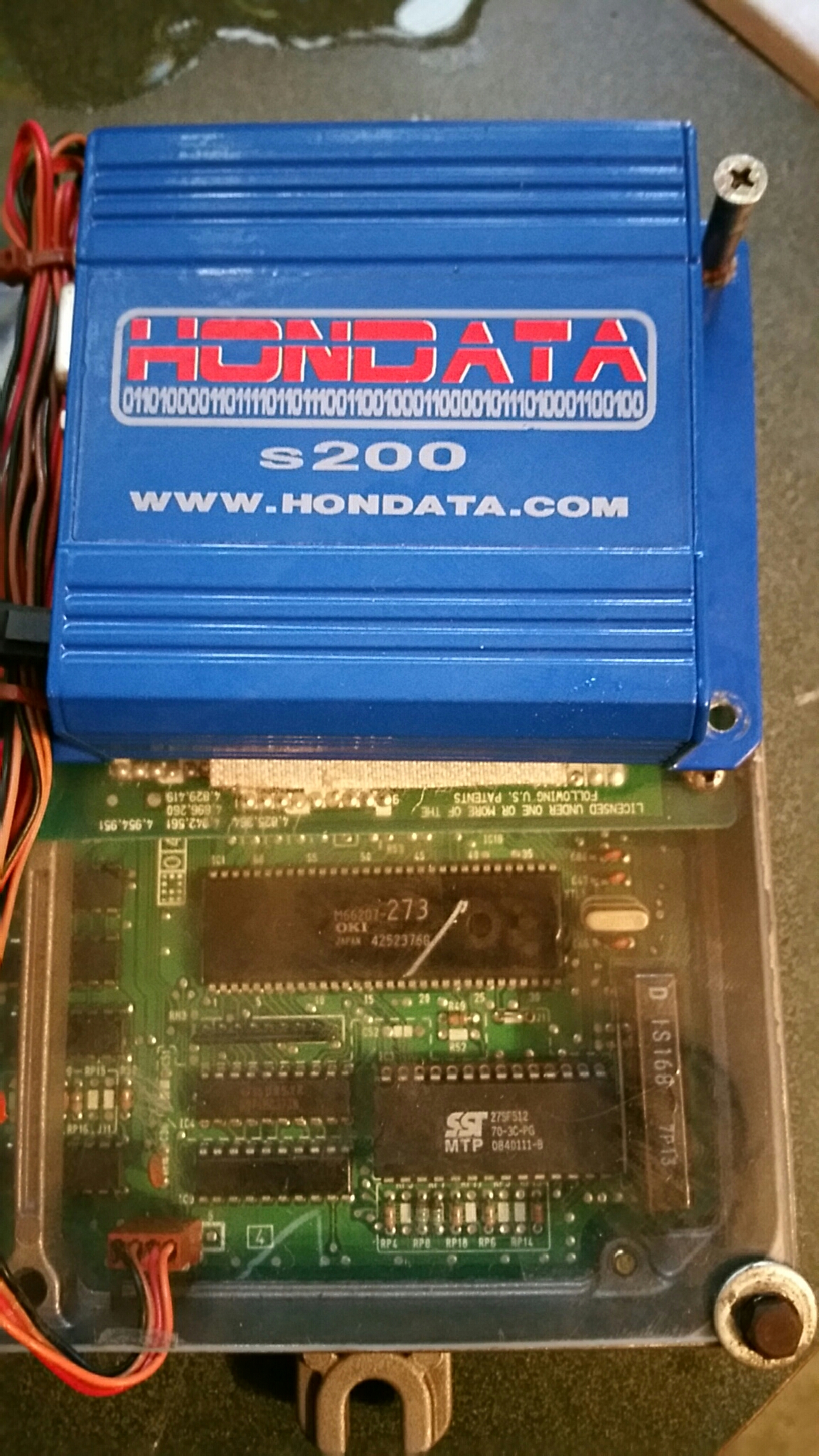

OBD1 P72 with hondata s200 using a GM 2 bar Map sensor

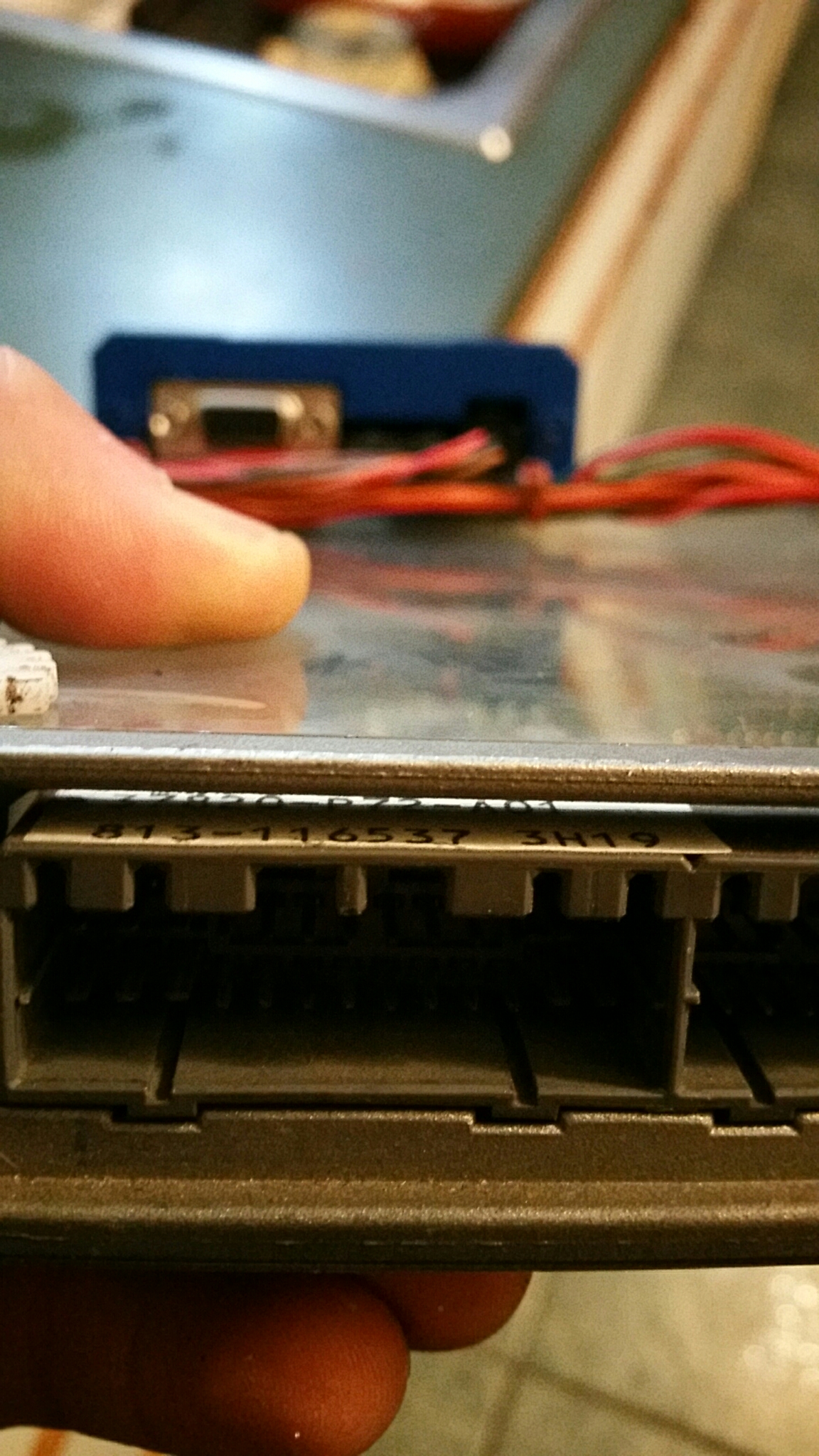

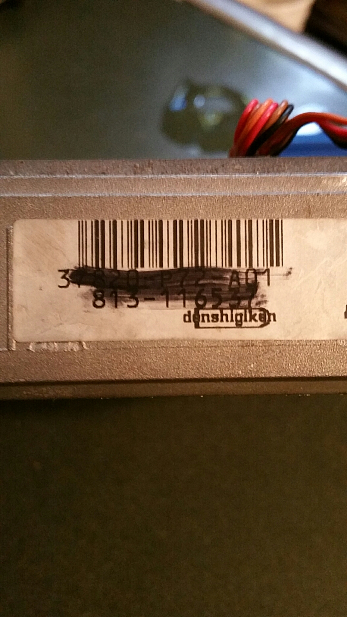

The blank space under the J1 jumper and the p72 designations lead me to believe that its s obd1 GSR p72
Im pretty knowledgable so feel free to not hold back any complex information or troubleshooting directions.
