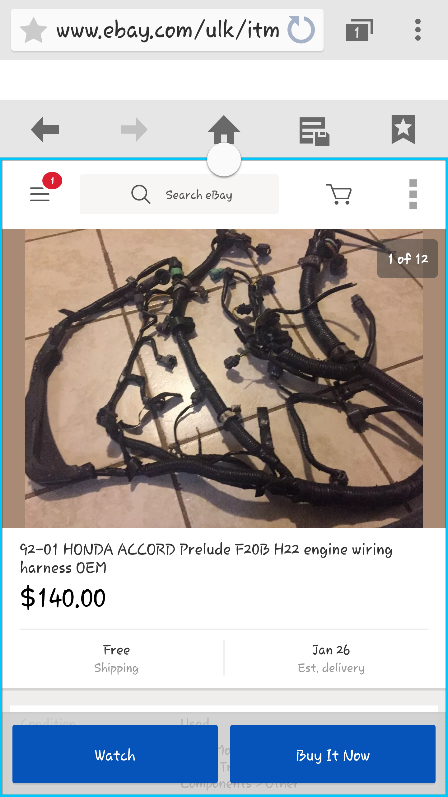

Video of startup and bogging Apexi controller
Will this solve my problem or at least put me in a better place?
Or do I need the 600 dollar Chase Bays harness

You should be able to use the TCU pins on the ECU.
I keep mentioning that your car is an extremely modified setup. What is your goal with this accord? Just get it running with the current setup, or do the modifications planned by the previous owner?

At this point I just want VTEC to function properly . If that means getting an OEM harness and unmodified ECU I will do it.

For Vtec, just make sure you get the proper pins on the ECU wired to the correct pins for vtec. Hopefully you have a wiring diagram for the acura ecu and the wires to vtec.

This H22 has iabs? And knock sensor? Arent those the butterfly secondaries? Do i get a manual accord cb7 harness or a H22a harness? Will def check them out.
At PA honda I will snap another photo now
Yes the h22 has iab's along with a knock sensor. I would do it so it's stock then you can mess with other stuff afterwards.
The oem wagon harness your car has already has iab's since it had the f22a6 engine. It won't have a knock sensor. You can add those with the kit suppied by axidwords.
It really would be best to just get it back to stock and then you can tinker with what whatever mods or chipped ecus as you want. You would need to source a p13 ecu.
