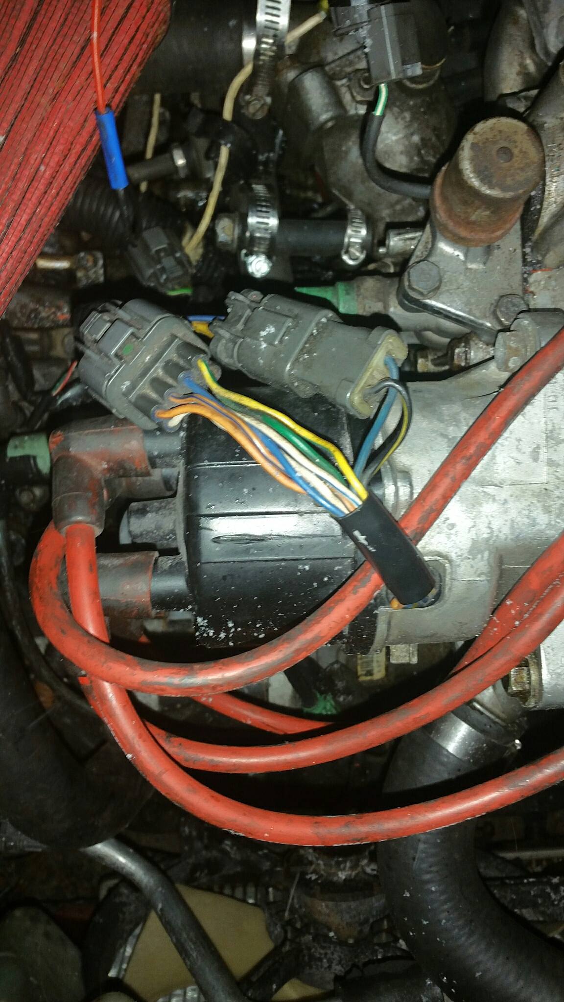

How many wires are going into the distributor?

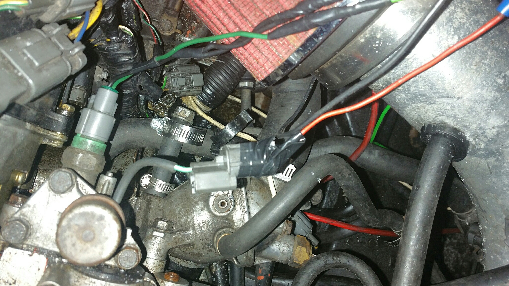

1 Picture uploaded. Will take anthoer pick right now

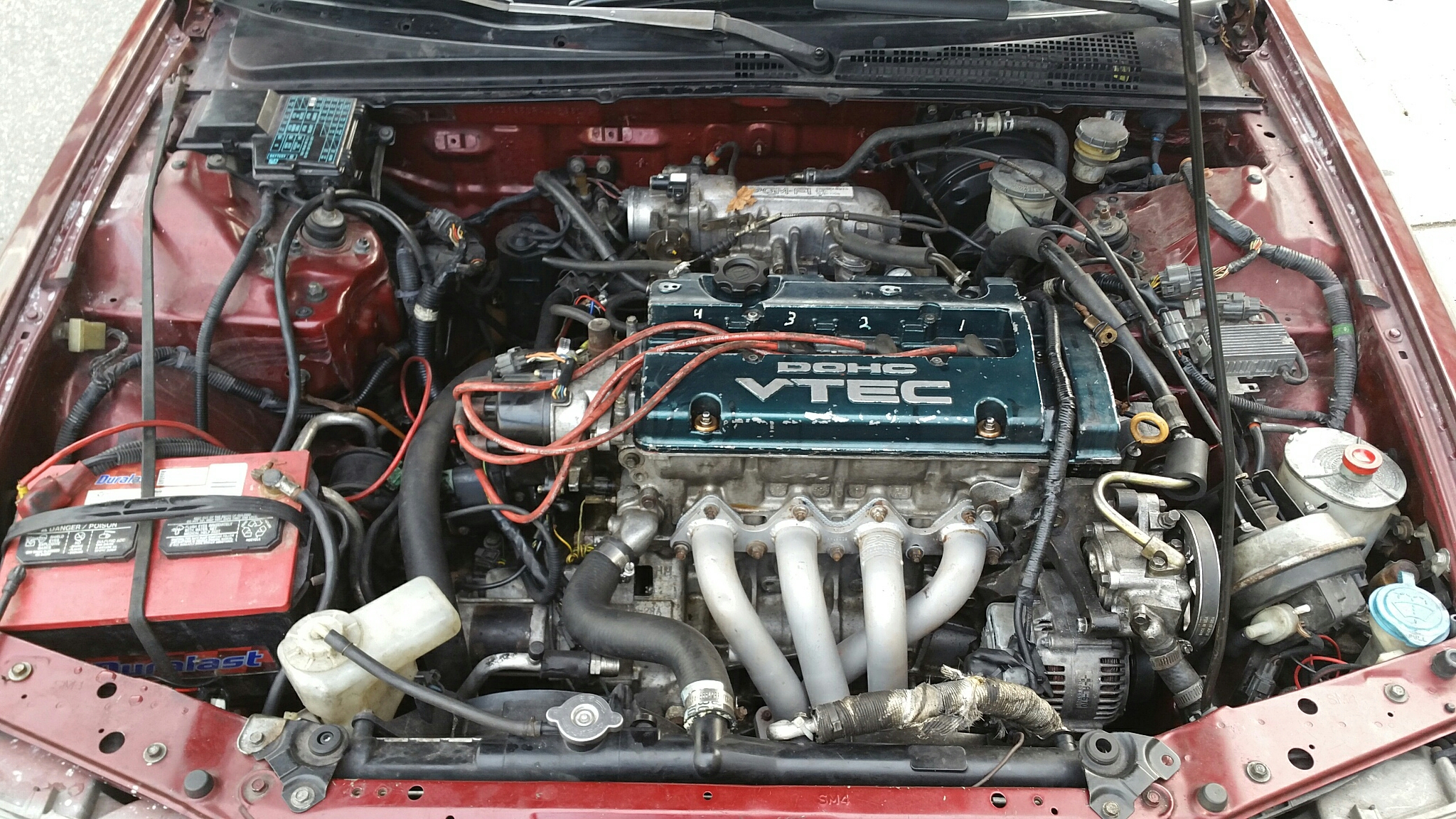

More pictures
Attached Thumbnails H22 in 93 accord ECU help-20160117_193153.jpg   H22 in 93 accord ECU help-20160117_193211.jpg   H22 in 93 accord ECU help-20160117_193046.jpg

Posts: 16,334
In the third picture, I can see the distributor has 8 (maybe 7) wires. How many of them are hooked up on the engine wire harness side?
All eight on the large and the two on the smaller clip have wires exiting them that go into the harness

Posts: 16,334
Then your crank angle sensor is likely connected to the ECU.
